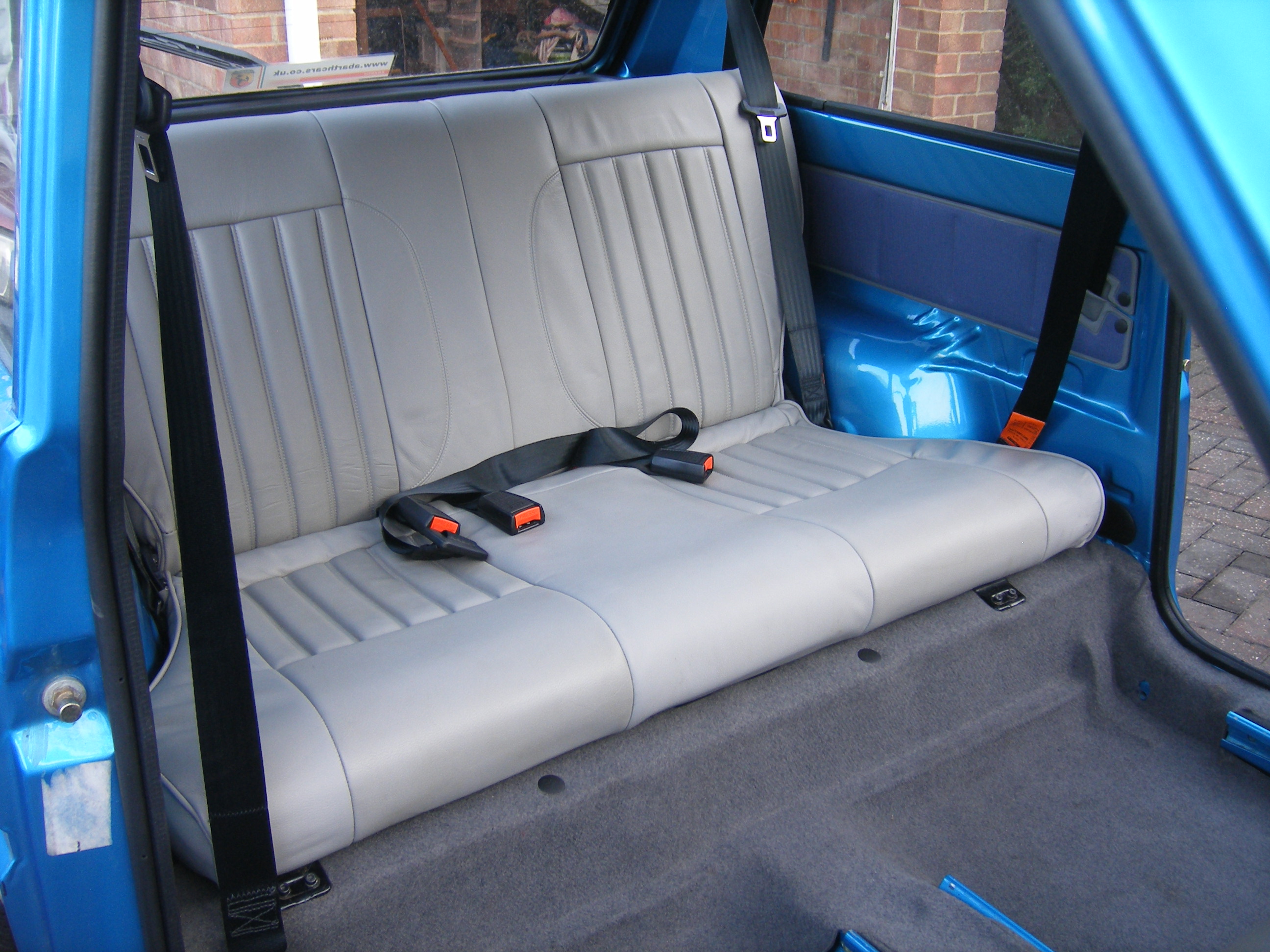

Rear seat is a spare I had covered, after much modifying, with the material from the Alfa back seat.

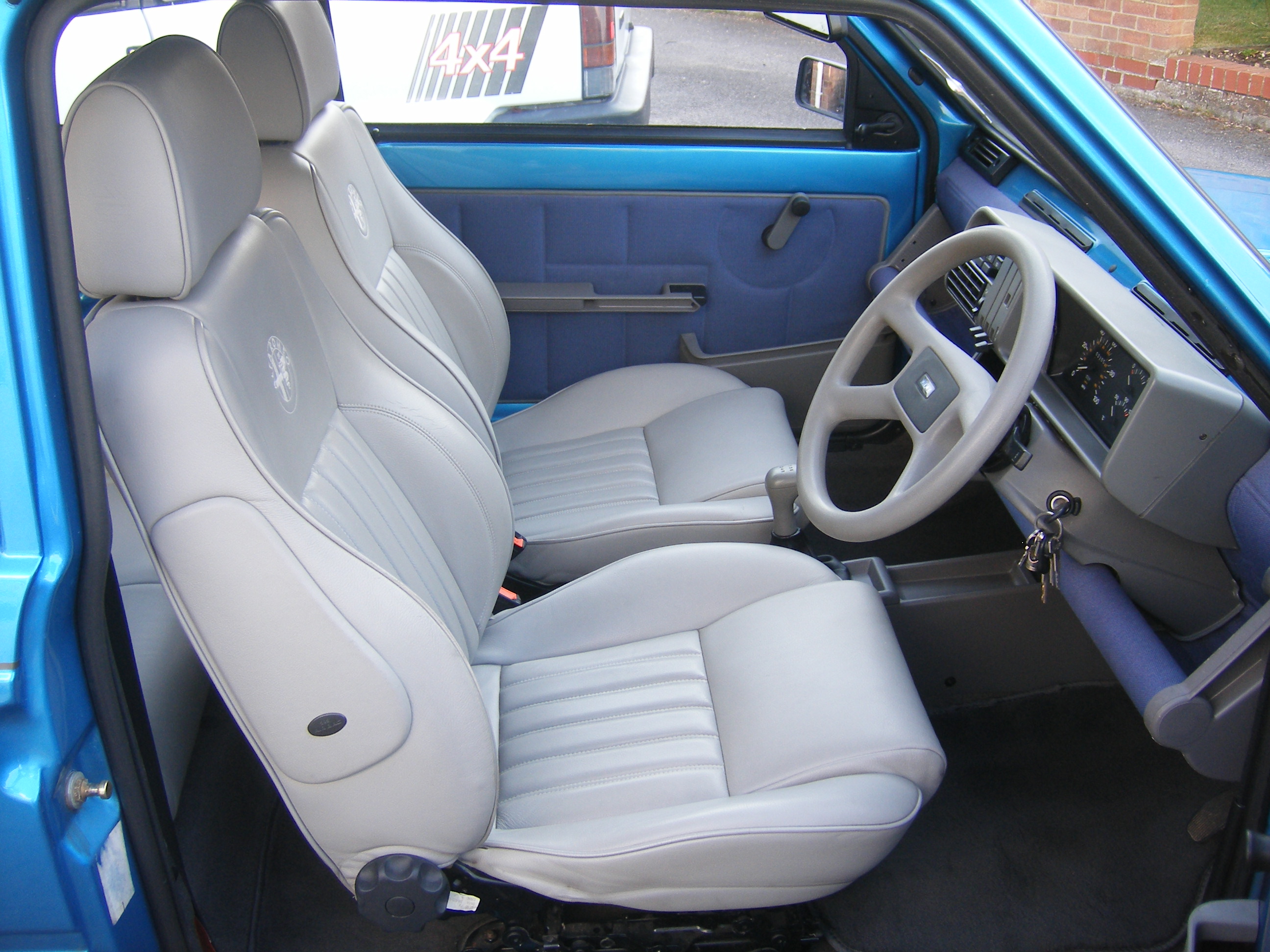

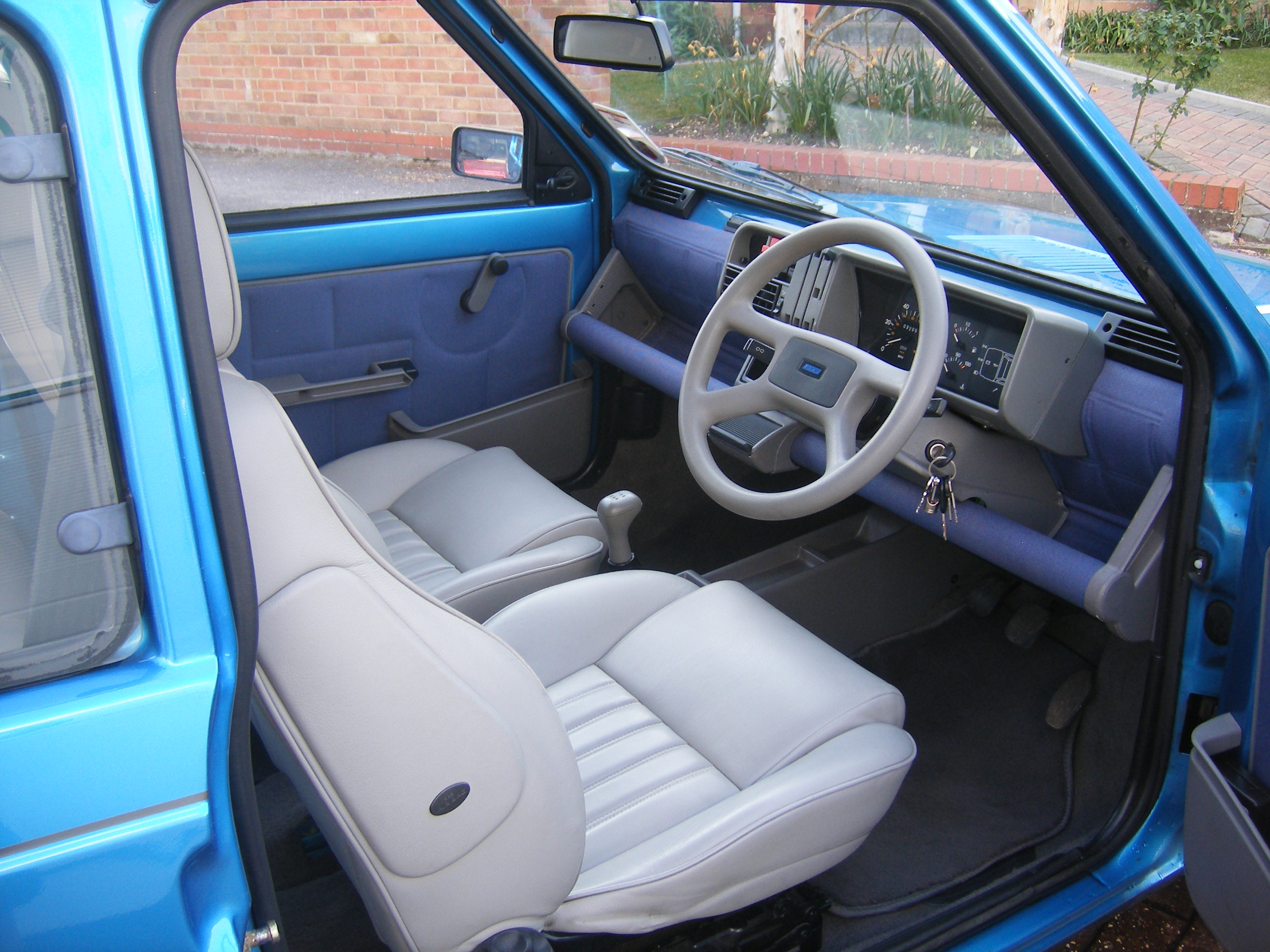

Then in, also modified, with the fronts.

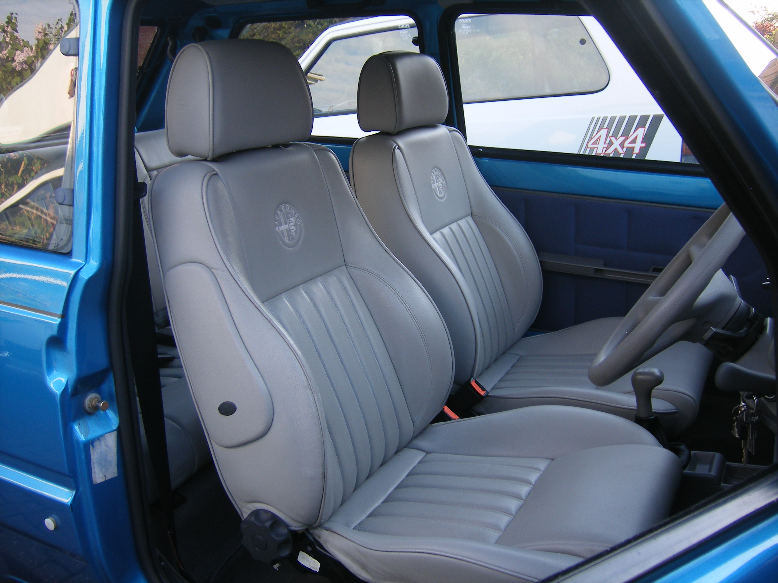

I'm stuck with the Alfa badges but I guess that's a small price to pay :p. I also have side airbags that do absolutely nothing, I just didn't want to risk causing any damage removing them to what are pretty tidy seats. I'm going to have a go at modifying the plastic side panels for the front seats so they can be refitted to hide the exposed lower framework, not sure it's do- able though.
They're a great improvement on the originals for comfort, long distances are far more pleasant now. Plus, if anyone in the future decides they really must have the originals refitted, all the runners are still there.

The drivers front seat is too wide to fit between the Pandas runners because of the height adjusting mechanism. My choices were to either cut out the original runners as I did with Charmania, or remove the height adjusting mechanism, I chose the latter. It means that all can be put back to original if necessary, plus the integrity of the shell is maintained so I'm not going to get into any arguments with the authorities. Once all this is done they bolt straight through the floor, with careful positioning. I also had to make some spacers out of alloy to bring the height up to an acceptable level.
