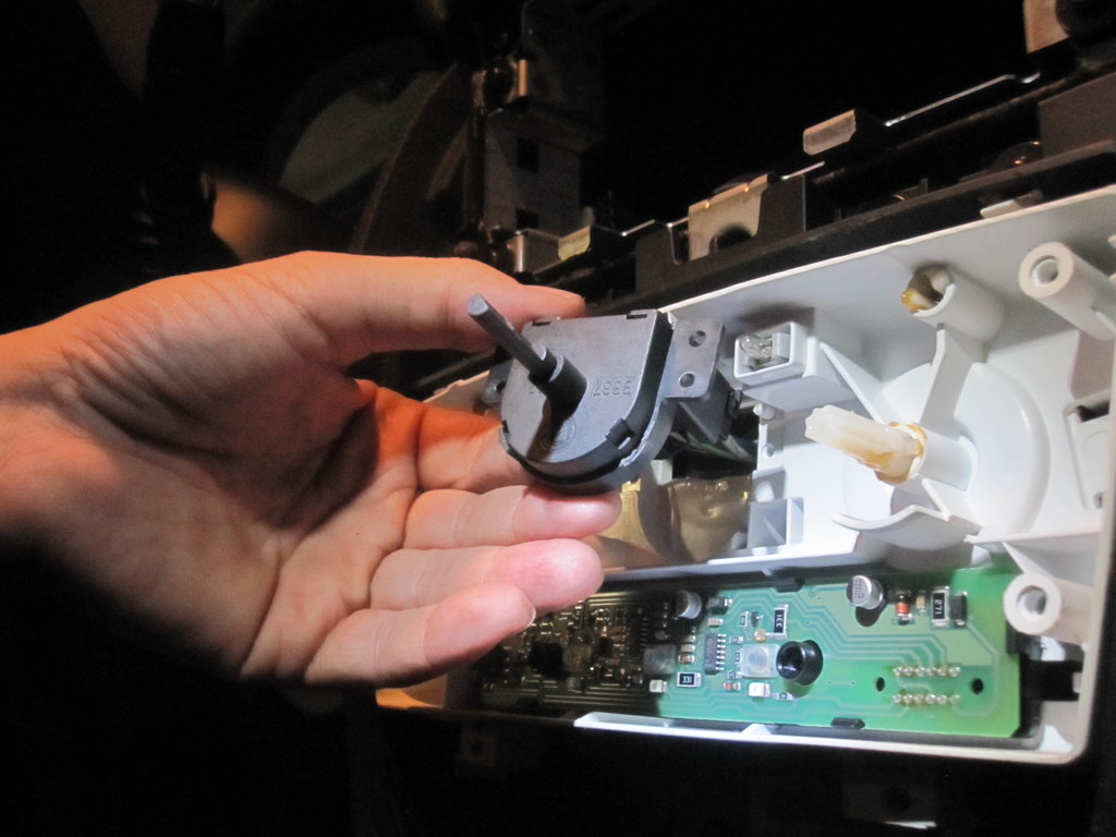

6) now you see the switch of the central knob - it holds in place by two small Philips screws. Unscrew these and the switch can be pulled out, dragging a cable with it. Unplug the cable - and the switch is free now:
![IMG_1879.JPG IMG_1879.JPG](https://cdn.fiatforum.com/data/attachments/104/104057-f98b80f3ef5f690778387185e1357800.jpg)
The switch only states "B837 12V" on it.
I managed to open the switch and fix it partially, cleaning the contacts, however I am still pending of getting a replacement from a scrap. Stilos are relatively rare, however it seems like the more common Punto Mk2 and Mk3 does use the same switch model. I will post update when I get one
