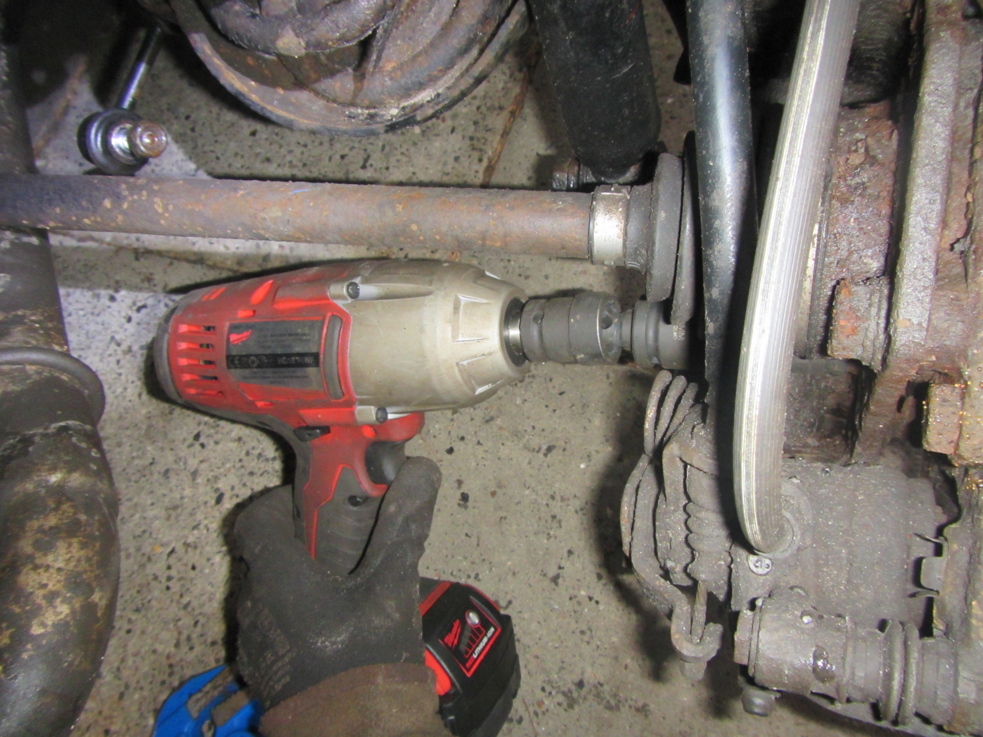

First thing is to remove the centre nut securing the axle to the brakes. (use the parking-brake, then the discs will hold the axle in place)
After losening the nut with the brakerbar, I used a machine to spin it off.
