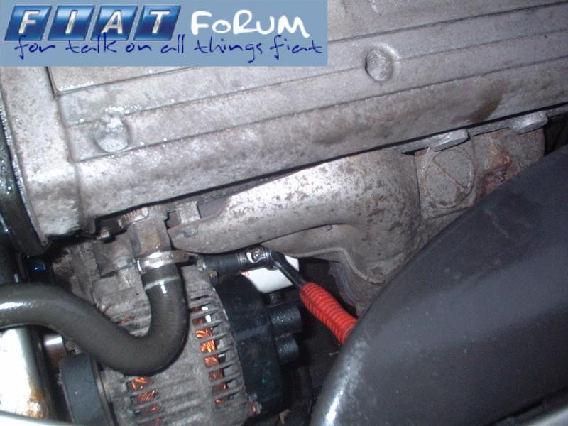

Next job is to replace the alternator and power steering belts. You can’t do the alternator belt while the power steering one is fitted as it’s driven from the same pulley and won’t go past it. So, at this stage the PAS belt is already off – easy enough. Loosen the alternator mounting bolt closest to the engine:
then the one nearest the front of the car. Just one turn each will do.

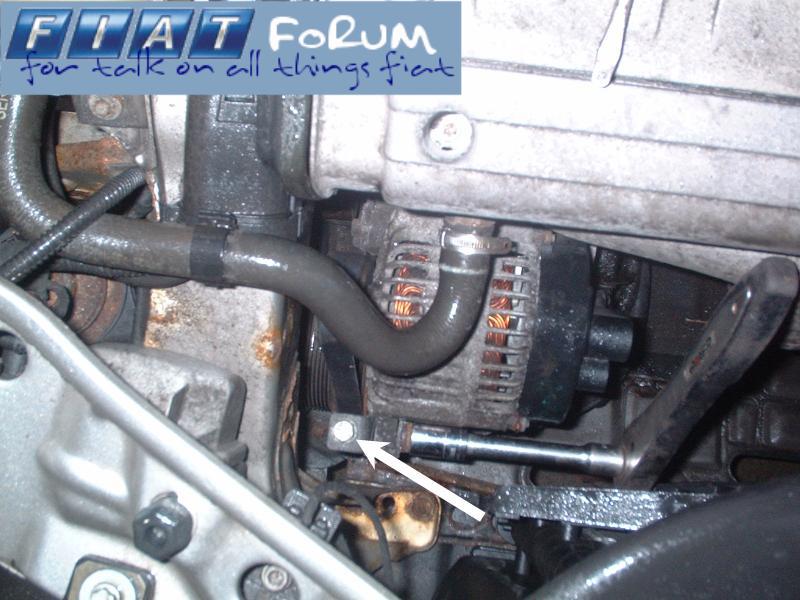

Now undo the tension adjusting bolt, arrowed in the above picture to release the belt.
Fit new belt and tension appropriately, then tighten the front and rear mounting bolts back up.
