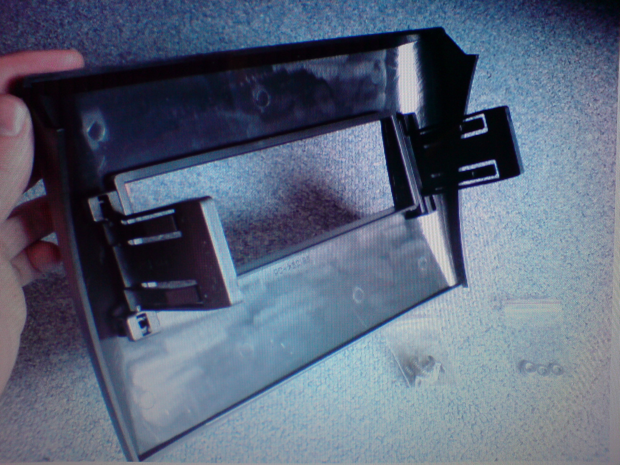

I beleive there are a few styles of facia plates that you can get for the stilo, there is a standard single openning one, a single oppenning one with a small cubby hole for storage and a double oppening one which could be used to install two device such as a cd player and dvd player. I chose the standard single oppnening one which i purchased from Ebay.
This comes with the main facia plate, two arms which will need screwing onto the main plate and four screws and four washers, you will also need a screw driver.

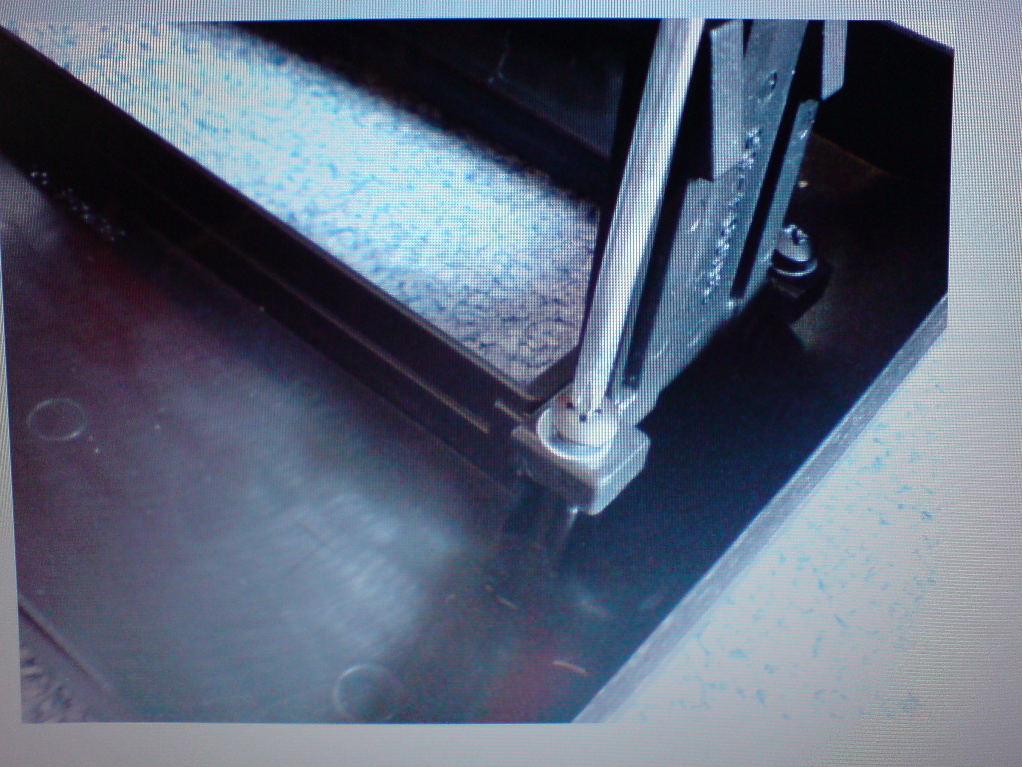

First of all you will need to align the two arms against the back of the plate so the screws holes line up, the clippy parts should be facing outwards, to know you've got it right the arms should kind of plug into the plate so that if you turned it up side down they don't fall off. Finally, using the supplied screws and washer you need to securly screw the arm clips to the main facia plate.
