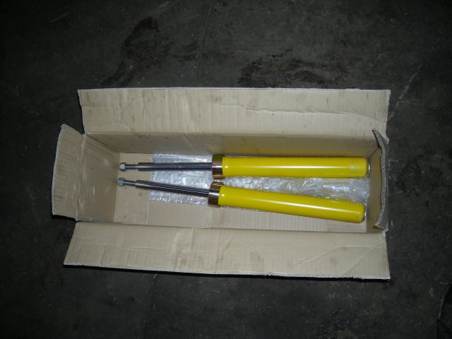

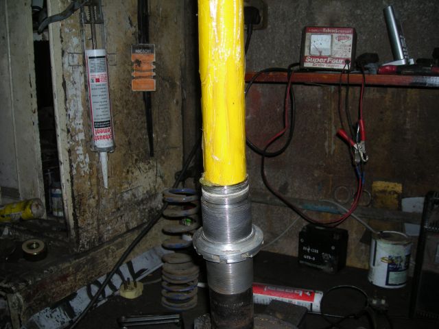

They come in the box like this:
Contents: damper unit x2, collar x2, cardboard seal x2, top nuts x2, bottom washer x2 (sellotaped to the bottom)

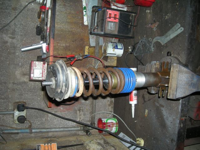

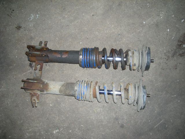

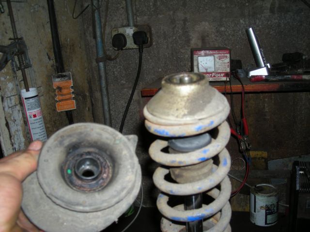

As you can see, one of them is in pretty bad shape.

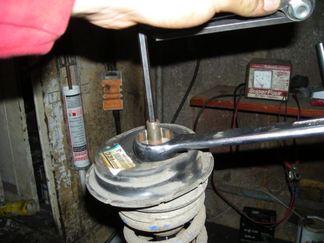

- Put a strut in a vice, and undo the top mount. The nut size is 27mm. You can either undo it s shown in the picture, with an allen key holding the damper rod from spinning. Or you can just blast away with a wizzy gun, which is infinitely easier. As you come to the top, make sure you push down on the top to stop anything springing out at you.
- The top mount and the spring seat should just pull off now, along with the spring, and any bump stops or boost you have.

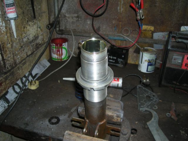

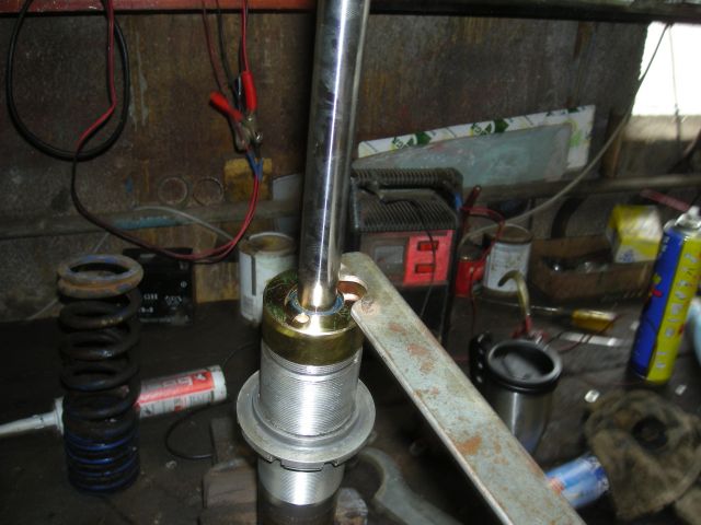

- Now undo the collar. You can either use a pipe wrench, or a big grinder spanner in the holes. Its a normal right-hand thread.
(yeah thats the new collar not the old, but you get the point)
- The collar and cardboard seal will now lift out, and you can lift the old damper right out of the housing.

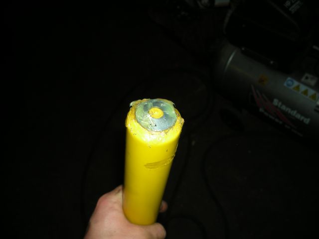

- Now, take the sellotape off the bottom, and use grease to stick the washer to the damper. I also coated the entire damper in grease, because the insides of the housing isnt all galvanized.
