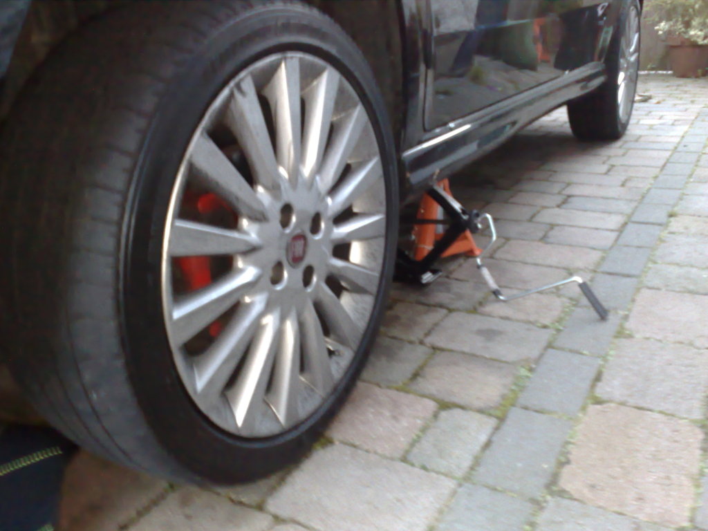

So, First things first...Open the bonnet & Jack whichever side of the car up the GSR goes towards. Most GSR's for the Punto's are aimed at the passenger side foglight area. You'll want to secure the car with an Axle Stand and bricks/chocks on the rear wheels to stop it moving (tbh i don't normally bother with either an axle stand or bricks but I have to tell you to use them so you can't sue me when the car falls on you whilst you're under it

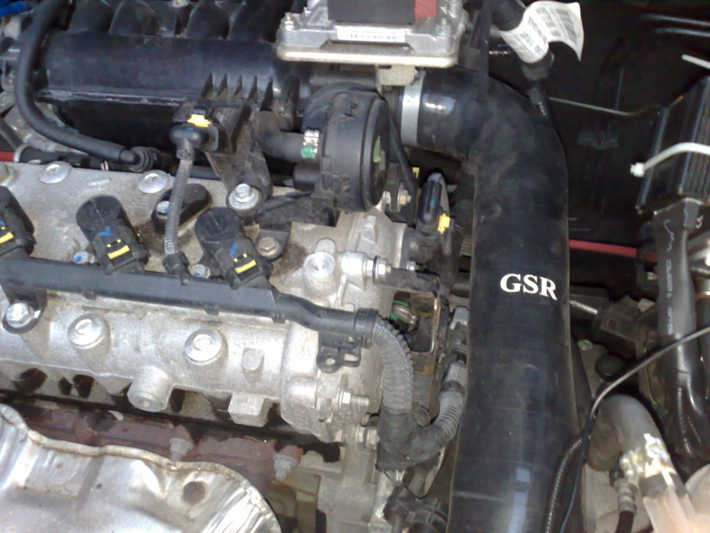

Once you have done that you need to remove the standard airbox. It's awkward to see from this picture but my airbox (and I assume the other fiat one's) is held in by 3 screws with washers which screw directly into the engine. The pipe which goes from the airbox to the engine is held on using spring clips.
First thing to do is to remove the pipe. The easiest way to do this is to get the pliers onto the spring clip either side of the clip which holds it closed. Once you've located the pliers simply close them which will push the clip together. Use a flat bladed screwdriver to force the clip upwards which will release the clip completely and hence release that side of the pipe. Repeat this on the other end and then pull the pipe away from both the airbox and the engine removing the pipe completely.

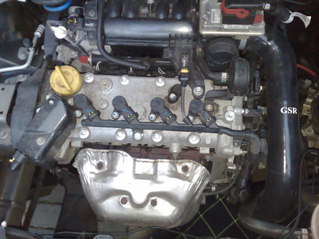

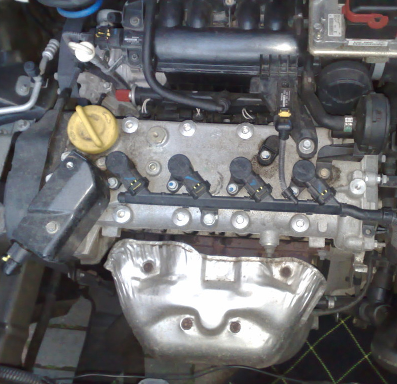

Now that the airbox is disconnected you can undo the screws (they will be easy to locate - usually one on top and one on the left and right sides.) and then lift the airbox off the engine which should leave you with a bare engine like so:
Now then, the next thing to do is to fit your GSR!!

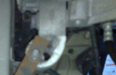

First things first, you need to locate where the underside bolt needs to go! If you get under the car and look toward the side of the engine where the GSR will end up (in this case the passenger side) you should see a part of the engine which sticks out and has a hole which is easy(ish) to access as shown below:
Now, the bolt will fall through this hole unless it has a washer on it to stop it doing so! So you need to prepare the bolt by putting a washer onto it before installing it on the car.

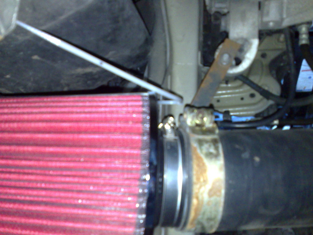

Once fitted from the bottom it should look like this:

Now, because the filter is held in place securely it is easy to connect to the air intake. I find it easier to lock the screwclip (don't know what they're called!) together slightly before fitting the filter and then slip it losely over the end of the piping.
Then push the piping over the edge of the air intake (should be a very snug fit - will require quite abit of pressure) and then tighten the screwclip until that can not be tightened any more. If you try and move the filter pipe it should flex but not move away from the air intake and the filter itself should not move from where it has been secured.
