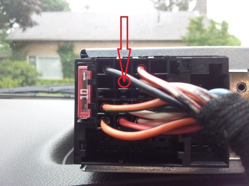

Fitting remote wire to HU
The only part you cannot do yourself (only if you have specialized radio ISO equipment). Go to the local car shop, and ask them if they can connect a wire to the ISO connector for you. Tell them to plug the wire (you already layed from the HU to the boot) in the following hole:
Once they connected the wire to the ISO connector, plug the radio back. Be aware that you don't squeeze the newly layed wire with the radio! The radio should easily refit and stick to the housing.
