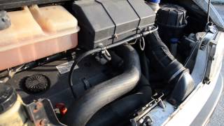

Just after the air filter is a sticking out clear plastic cylinder. The idea is that it shows red if the air filter is clogged.
Un-screw this unneeded item and with jubilee clip connect half a metre of old 8mm gas tube, the stuff left over from a renewing your gas bottle feeds. From there use a suitable adapter, I used a 14 to 10mm copper pipe reducer, and connect it to the engine breather pipe. Trim the old pipe as appropriate.
Now you can breathe clean air in the cab. You can use standard diesel too.
I drove the engine for a good 15 km before taking the Ducato in to be tested. Made sure the engine was warm and that the pistons had expanded well into the cylinders, in other words, and it passed with flying colours. Better values than without the mod in fact.
