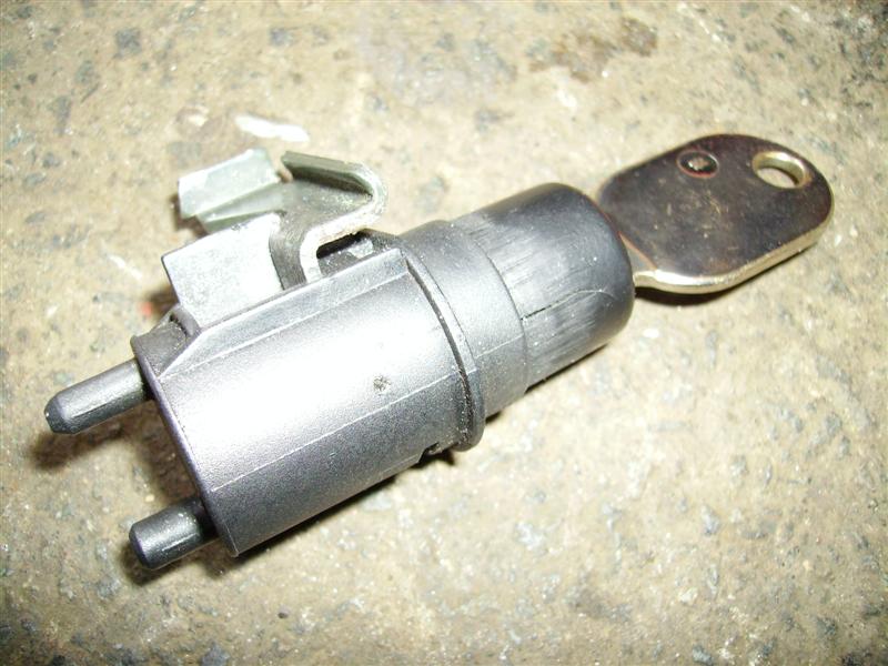

If your lock isn't locking/unlocking when you turn the key, look at the bottom of the lock barrel.
There should be a little ~4mm diameter cylinder protroding from the base that inturn fits into the slot in the metal locking piece.
When the key is turned this should move the metal and lock and unlock the boot. In our case this has sheared off! :confused:
To fix it we need to drill a hole, tap a thread, and fit a short M4 bolt. :)
First of all take a 3mm drill bit and carefully drill a hole right in the centre of the circular mark left by the sheared off cylinder. Carefull not to go too far or you will damage the lock pins. And don't leave the key in the lock barrel whilst you do it or you will drill your key!
Next get an M4 tap and thread some turns into the hole, again don't go too far but you want about 4 good thread turns for the bolt.
Here is my lock with the hole tapped.
