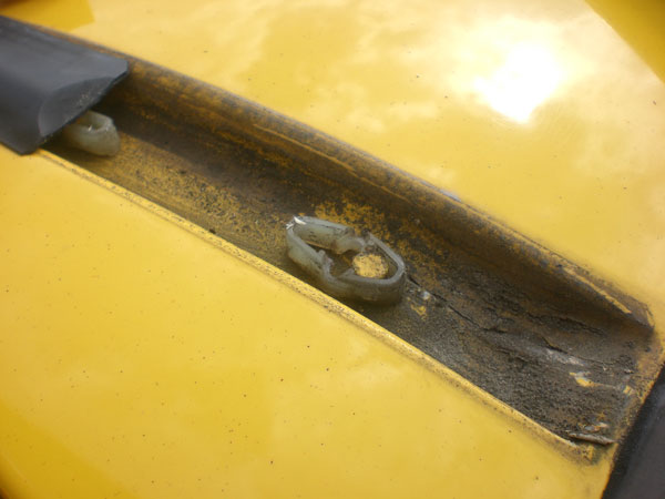

This is what is revealed. A total of nine small clips that fit over skinny mushroom shaped pins sticking out of the roof channel. I took these off by gently levering them with some needle nosed pliers. They can be used again.
