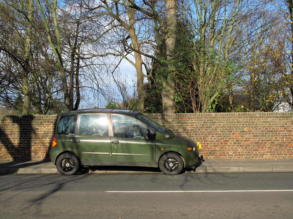

He bought it as a respectable family car
After much abuse and going up and down like a whores drawers I bought it looking like this....
