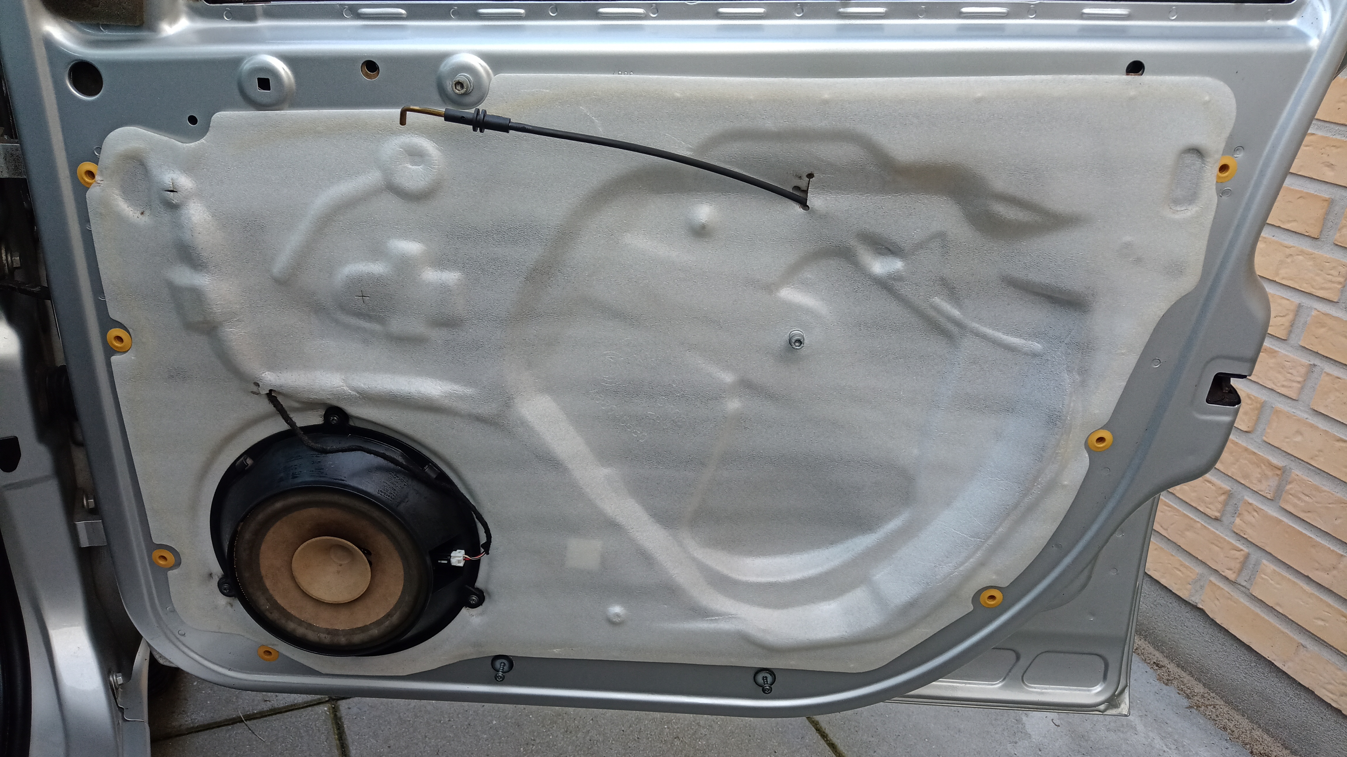

New stereo featuring DAB+, Bluetooth and matching colours. Lets me listen to Roon's mobile access function named ARC while cruisin' down the road.
Also, I can then talk on the phone, handsfree. Nice and legal.

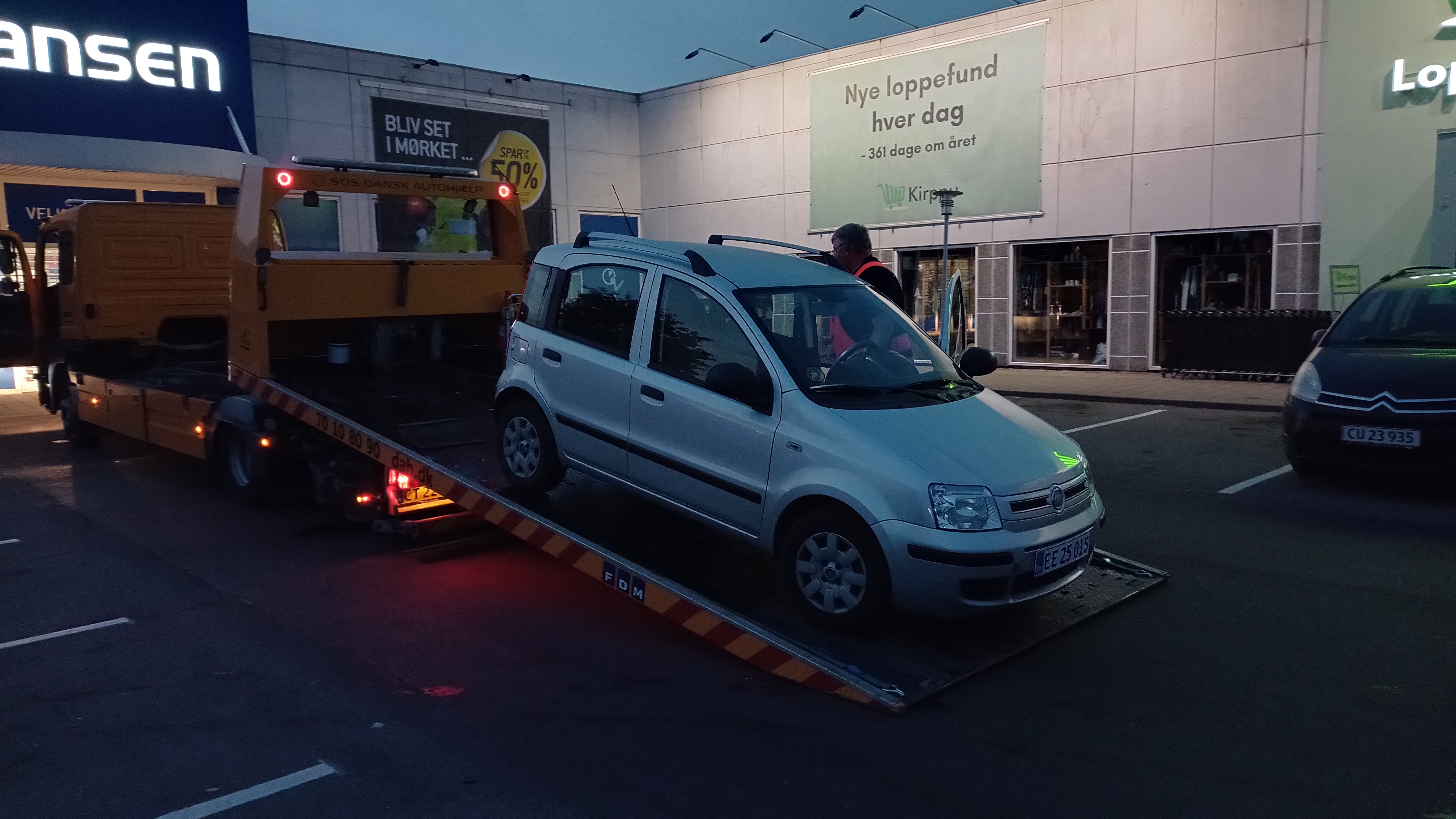

Well - day two of my ownership I had this experience:
Repair shop fixed the non-starter by replacing the infamous earth strap and I could move on.

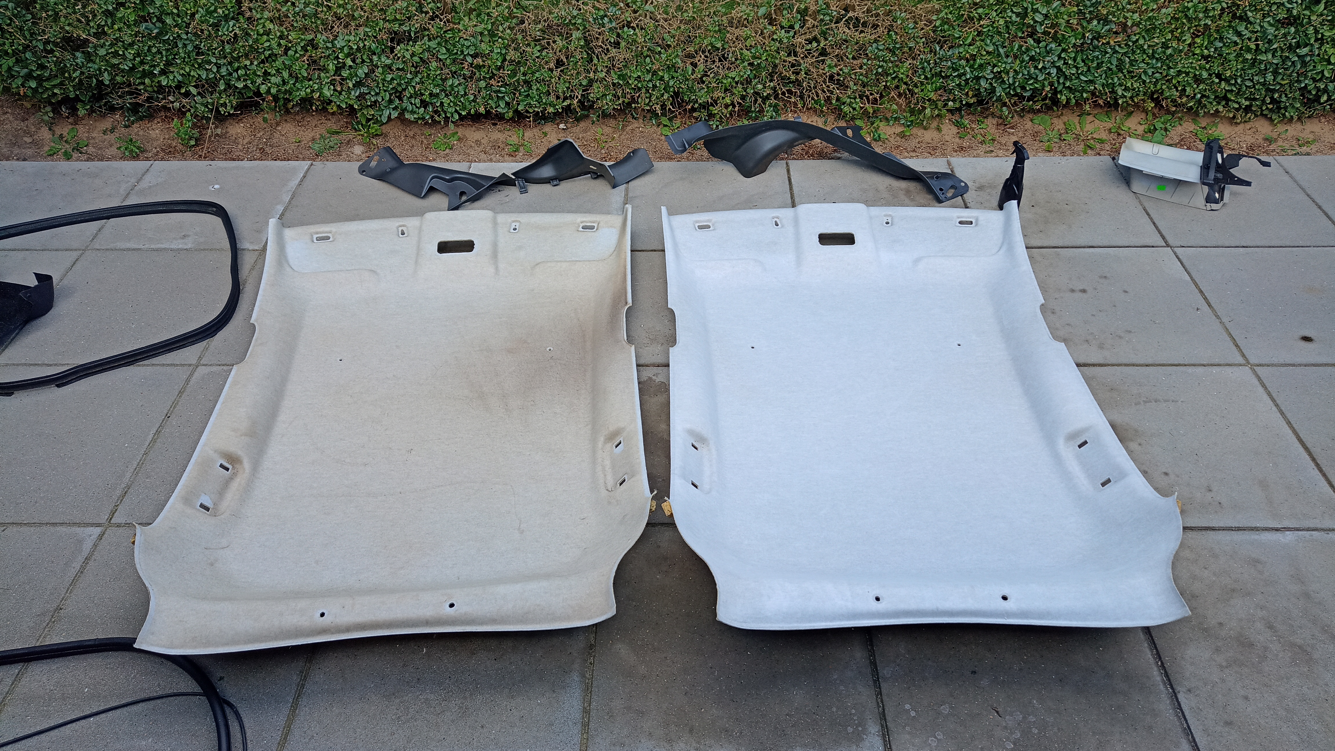

Tear the cabin apart to get rid of the brown fumes and replace the lining while I was at it.

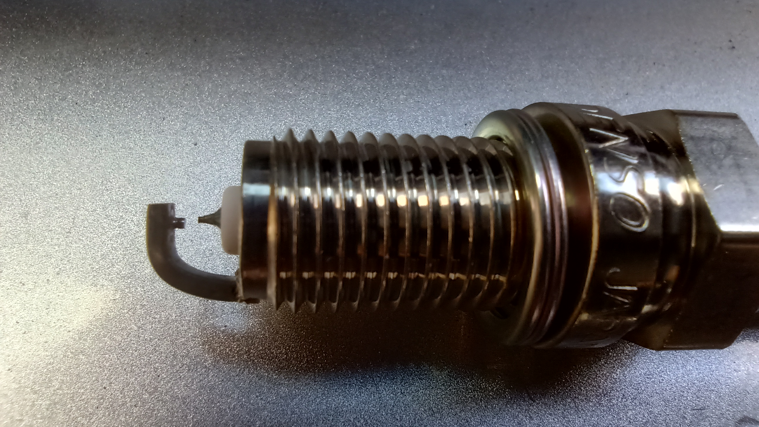

I suspect the plugs have never been changed. Gap was a whopping 1.8mm on all four plugs, they were marked "FIAT" and were quite rusty. Also, airfilter, oil+filter (no pics of that) were done. Basic maintenance. I'm waiting for an opportunity to replace the coolant (Glysantine G65 waiting on a shelf). Gear oil + brake fluid on the ToDo-list...

Currently working on the nice stuff and externals. Badges, paintjob, lighting, farkles, stereo + handsfree phone:
