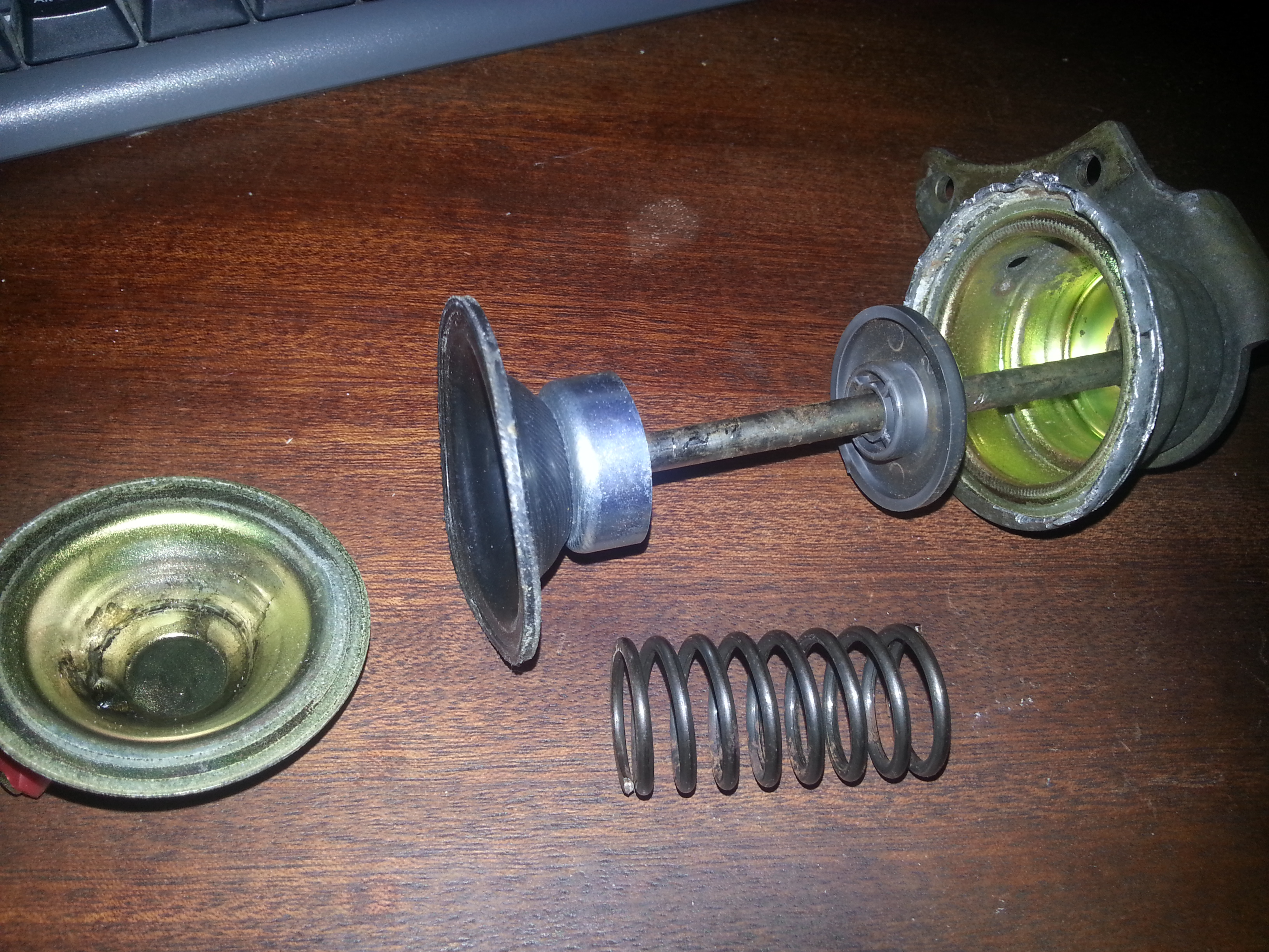

Next is a bit of a bigger project, the 1.2 Turbo Stilo
So I start cleaning it up a bit
Here I'm changing out the spring to try to get the wastegate to run at around 5 psi
And that's about as far as I got with the turbo other than getting everything sorted for the oil line. I got an adaptor for the oil pressure sensor to also feed oil to the turbo and got some steel braided cable for it.
For the outlet I still need to find a spot in the sump for the return. I still haven't decided weather or not to get a decompression plate yet for such little boost.
