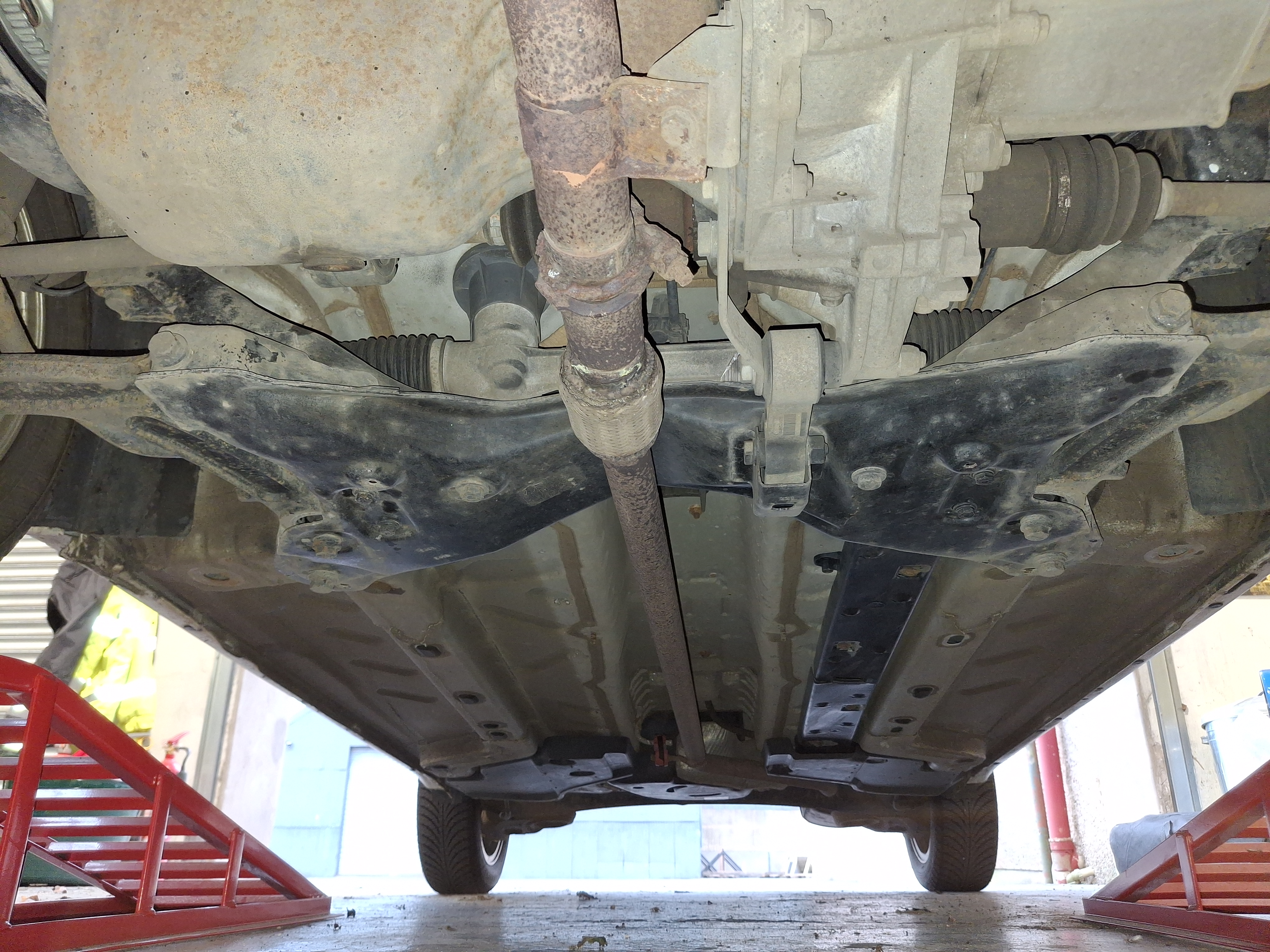

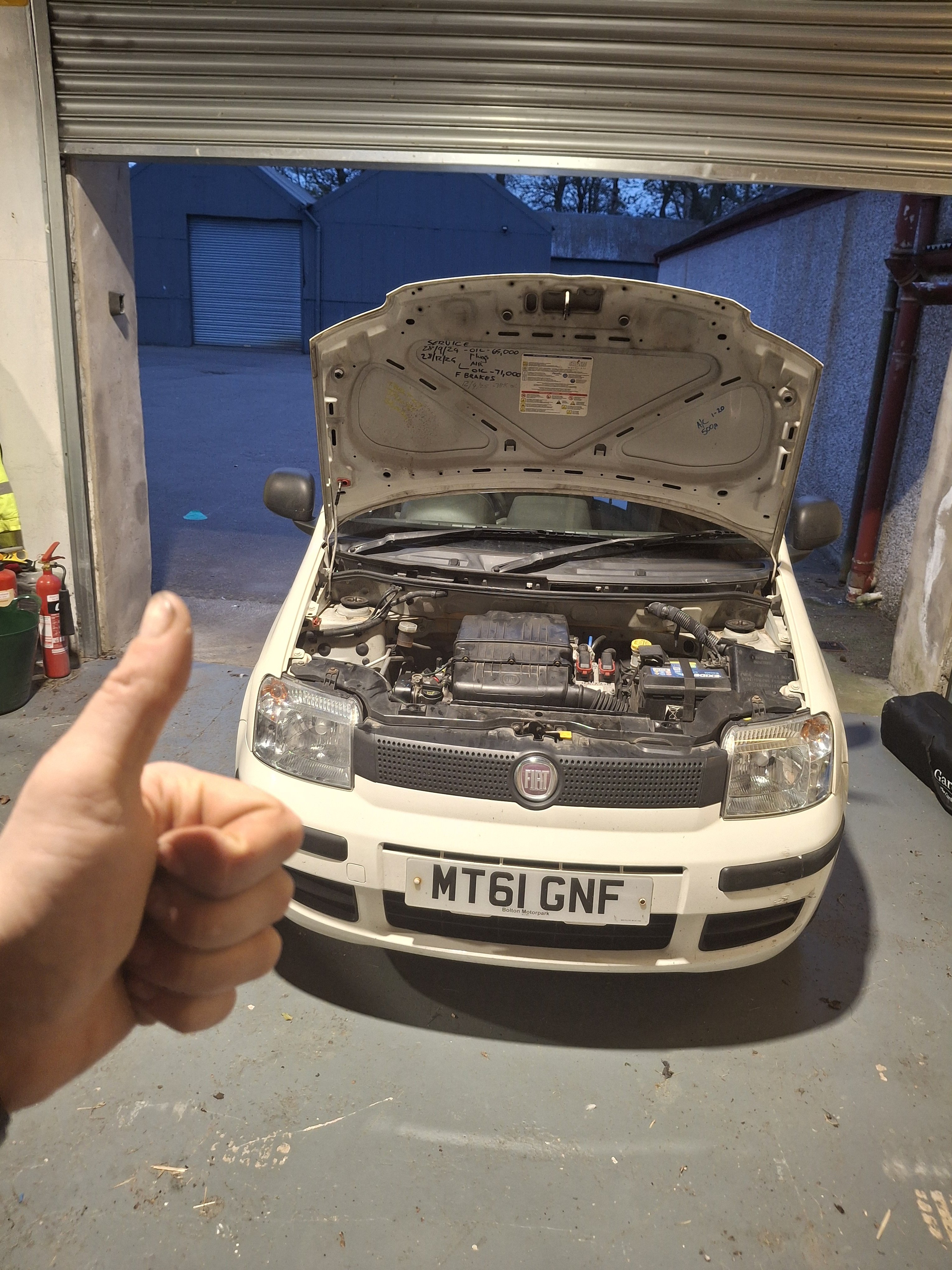

I had been busy with work and missed the 75K service but managed to catch it at 78K.
Just standard oil, oil filter, air filter and general health check for the little Panda.

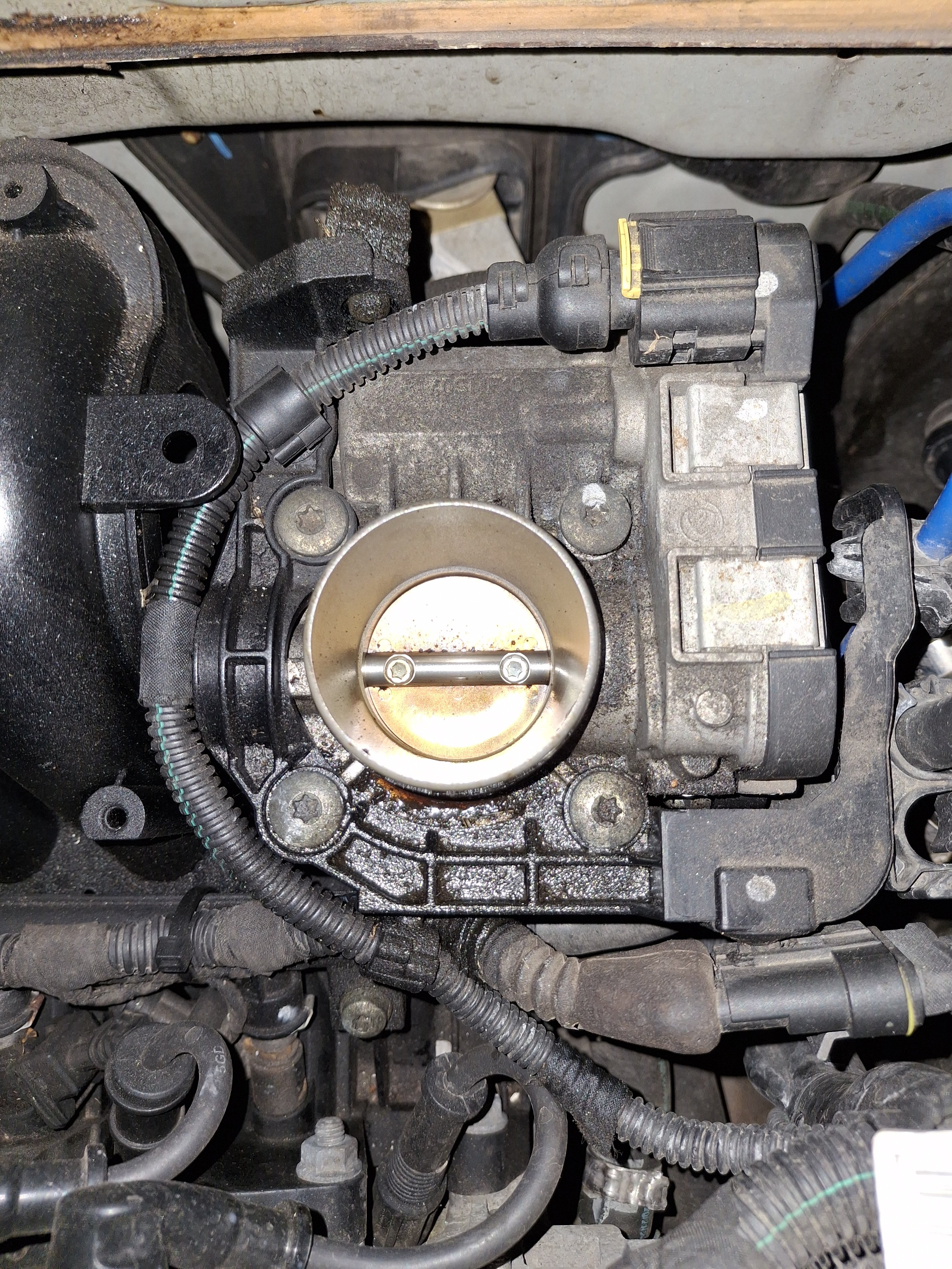

The butterfly valve in the throttlebody seems to not be gunking up as much as before, perhaps the more regular oil changes are helping?
After a few miles and turning left I'd get a sort of screeching from brakes, I think it was the lower portion of the dust shield contacting the disc, so I bent it back a bit and noise seems to have gone!
Underside is a bit dirty but still not much corrosion.
Really pleased with this little car!

Last did oil at 65,000, I know a 5000 service is a bit pedantic but I do a lot of miles and need this happy and healthy panda for getting to work and more importantly, home!
Replaced front discs and pads with brembos
Magneti Marelli oil filter
Mannol oil - same as I used last time, pretty cheap and Panda seems to like it.

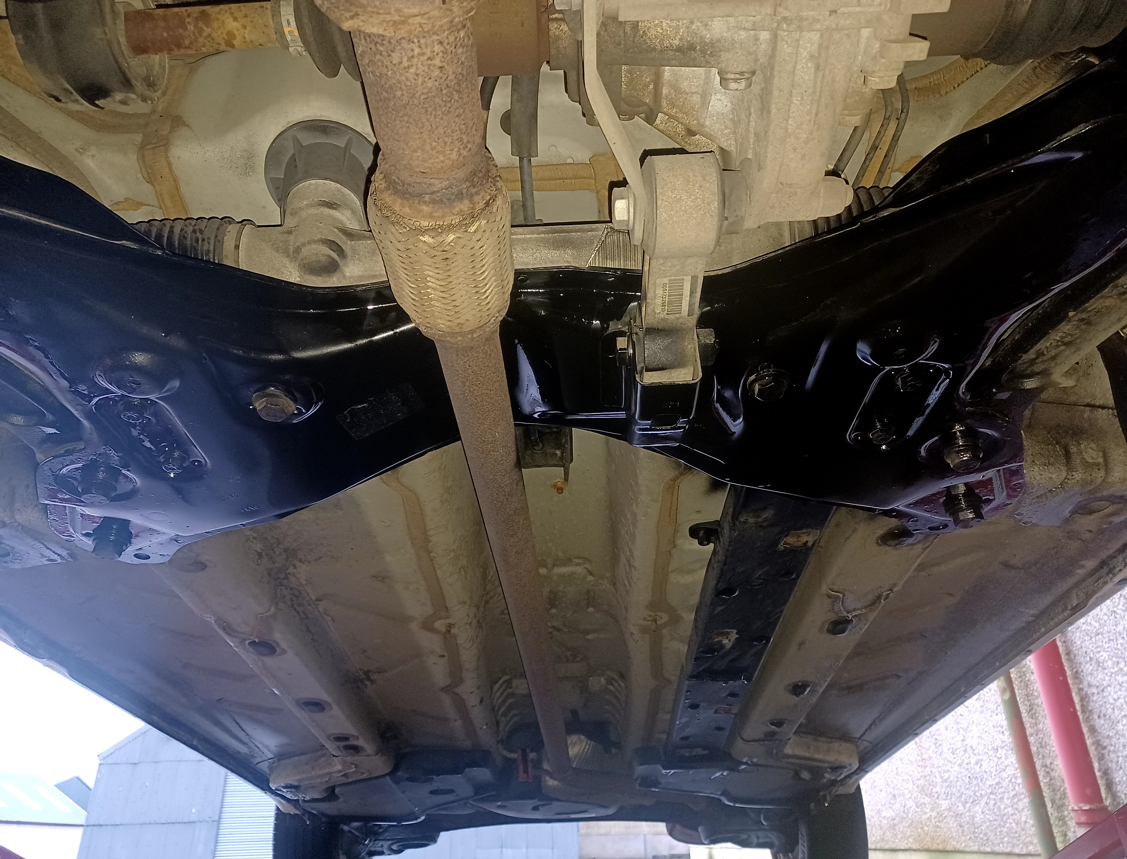

Also took the opportunity to clean and epoxy paint the front subframe - looking clean underneath!

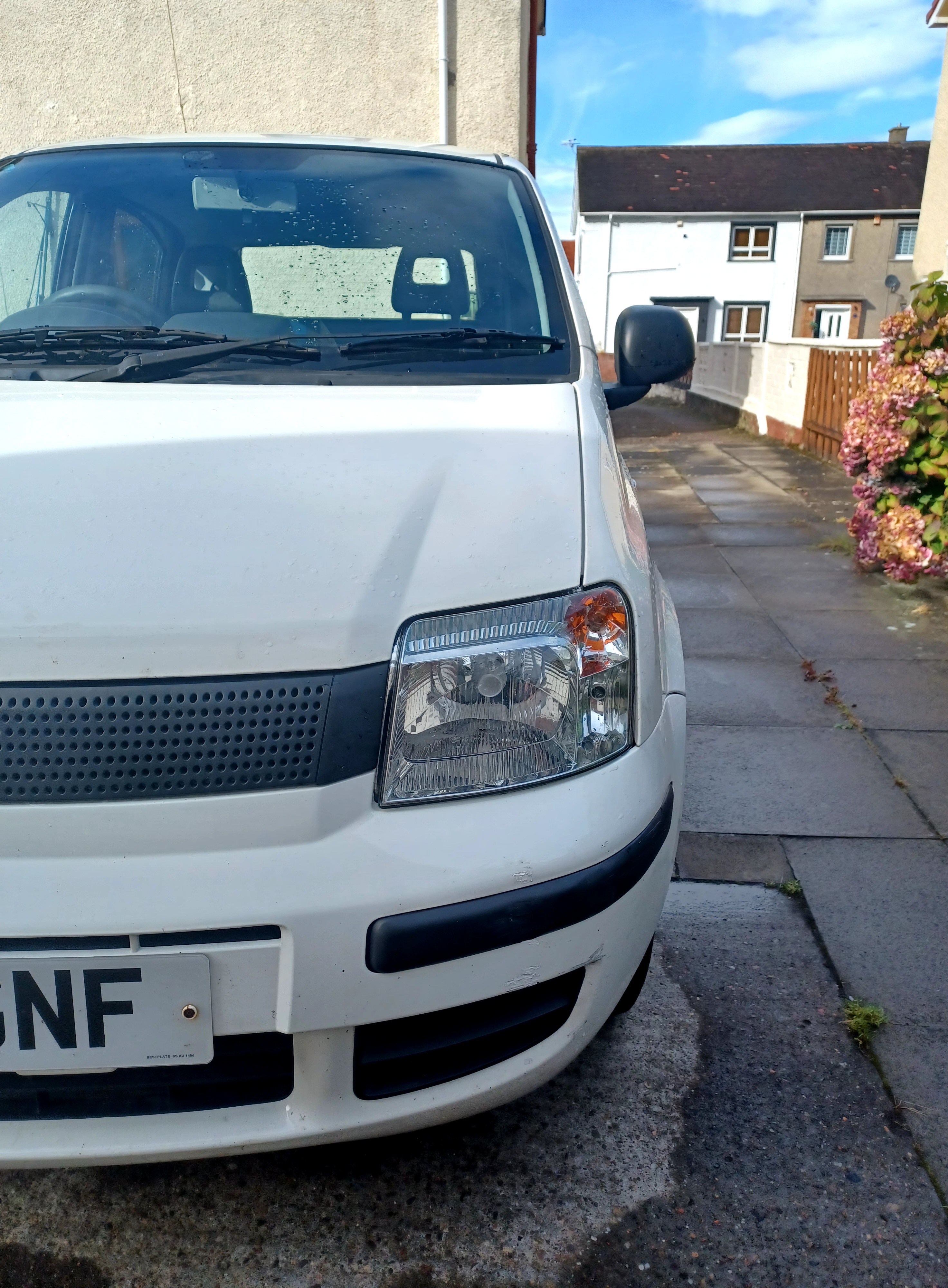

The nearside headlight always had a considerable gap between it and the fender, but I've tried my best to rectify it but the lower plastic bracket has snapped. It'll do for now.

I remembered from my 2004 Punto, the throttle body can get a bit gunky due to the breather hose from the rocker cover. Sure enough, it was a bit dirty. I was more shocked at the oil build up at the connection with the air filter box, gave it a right good clean out.
New air filter too.
