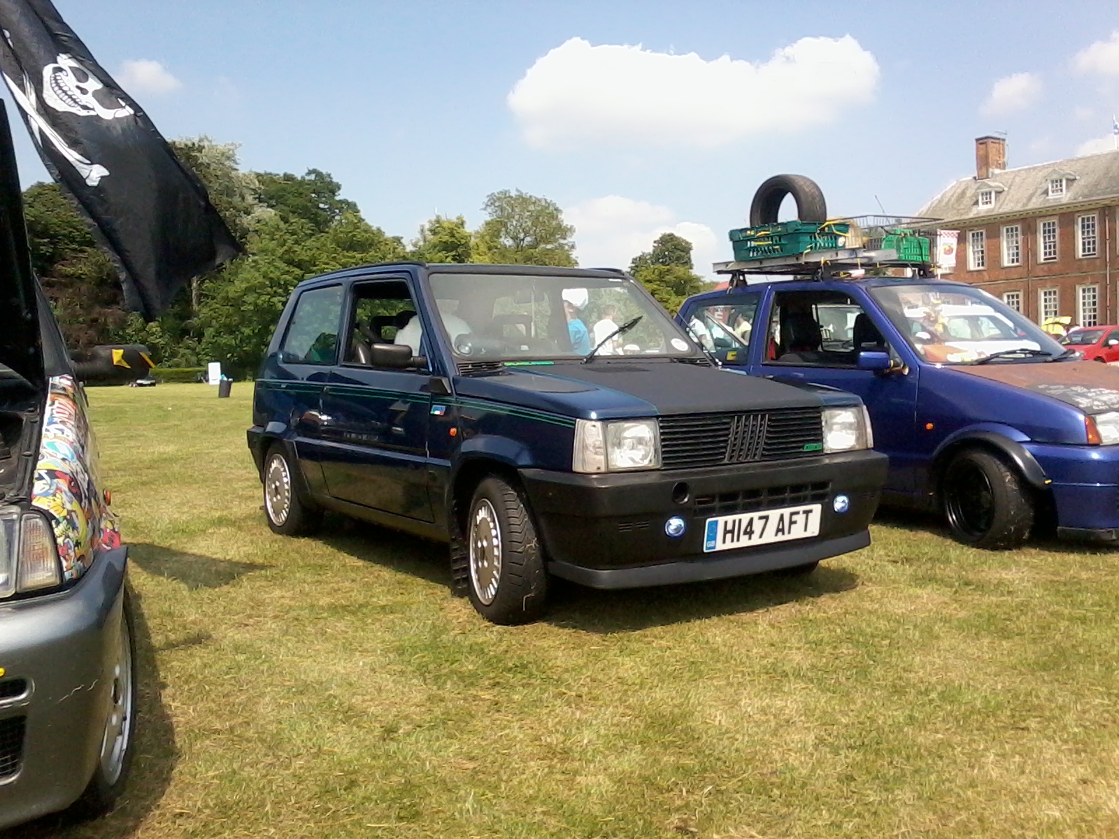

this is my car as it is now

umm twin sunnys. very nice panda (y)

You bought the Panda Sky! Well done, that's been up for sale for a while. Glad it's found a new home (y) hopefully your aware how rare that car is? Lowering it will be fine as it can easily be reversed in the future but I'd be careful to keep it as original as possible as that car will be worth good money in a few years if you keep it in good nick (y)
Only 12 left and 6 of those on sorn :eek:

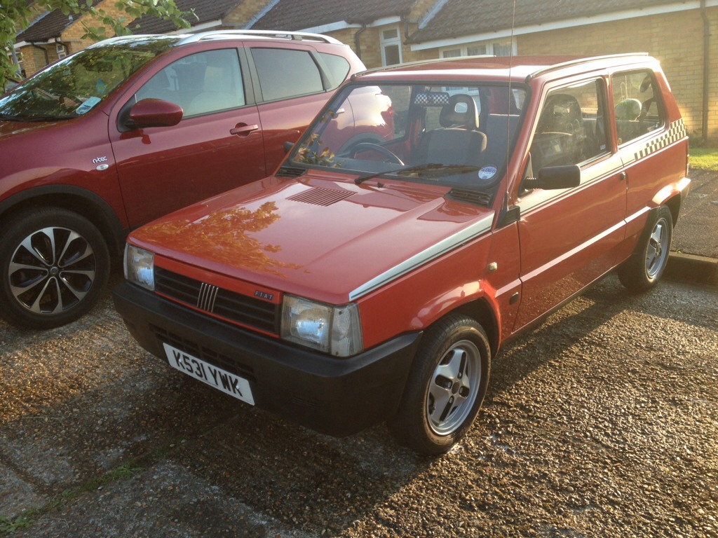

Or here's mine. For a splitter all you need to know is the bottom of the bumper pretty closely follows the shape of the Mk2 Golf (pre 'big bumper' facelift) which opens up some options.
