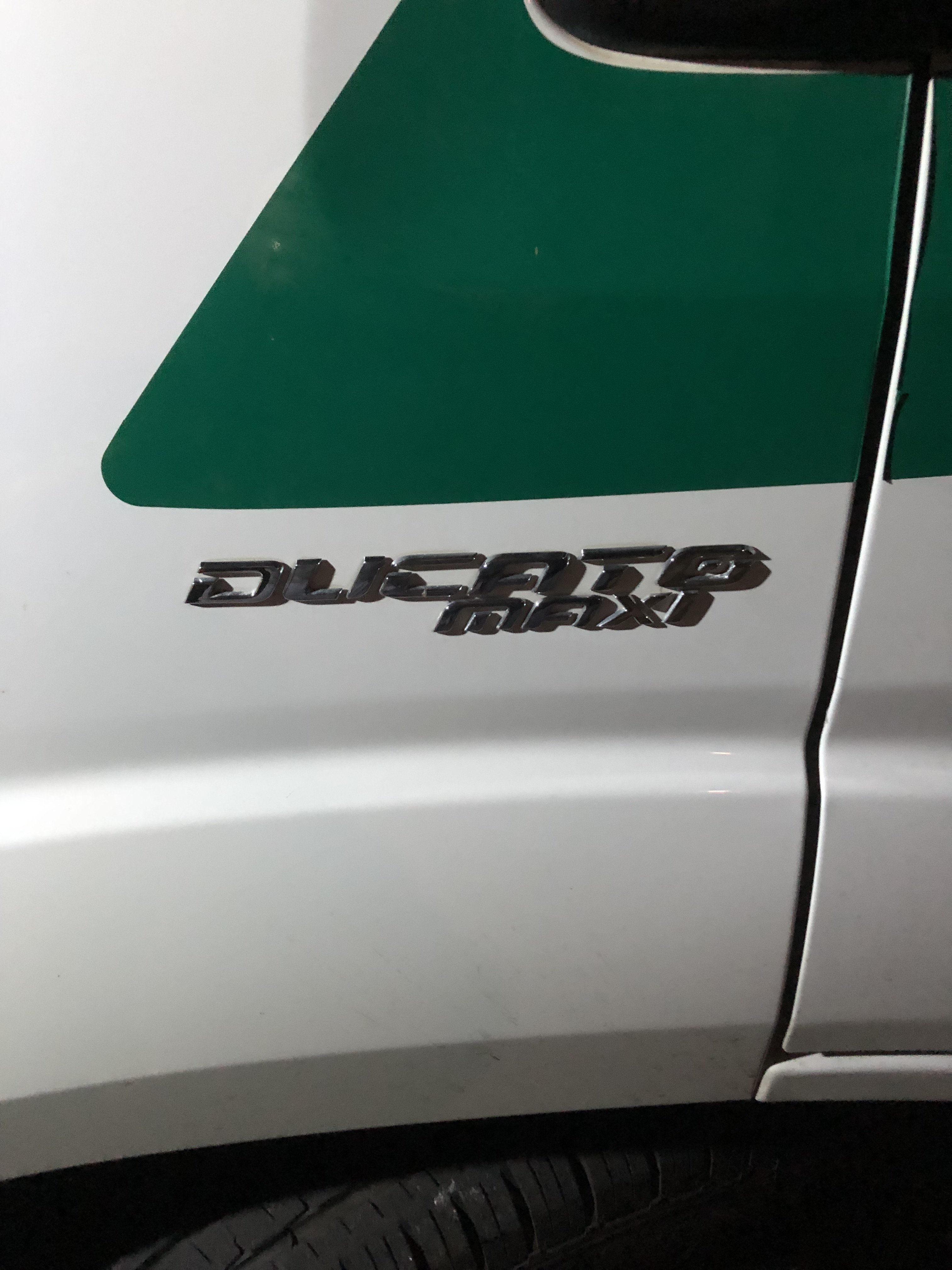

2015 late ducato with 3 litre (motor home). No windows, brake lights and clearance lights. Six weeks ago had a aftermarket pioneer CarPlay unit with connects2 kit. Last Sunday got an look over before going on a trip. No lights then windows.
So dealer blamed radio. Comms issue. I’ve read it will flash mileage if that. So factory has been put back in. Car scanned no readable faults. Been though all three fuse boxes swapped fuses as under bonnet one sealed can only visible. Brake switch is working. Had connect a relay and run a wire to back lower brake light to drive / move. Indicators still work. Has led headlights and has message on dash been in for six months.
Battery light/ warning light on cluster are dim on key turn off for 5-10 seconds. Driver door grommet was not in too. Note this is my brother in laws fathers van. Being an accessory fitter for twenty seven years im doing what I can.
