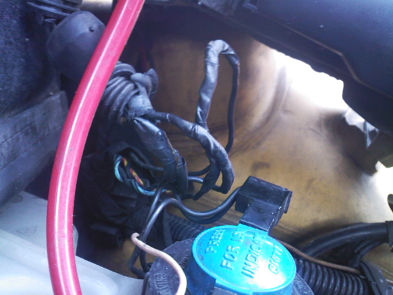

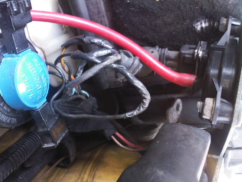

Right well, after reading this i went and read all the posts i could to try and see where said FCD would be.. i can't see one? If it's connected to the map sensor then all the wires look like they've been cut and rejoined, so the FCD may have been removed? no worries though as the car hasn't been moved or been left running for long in a long time!

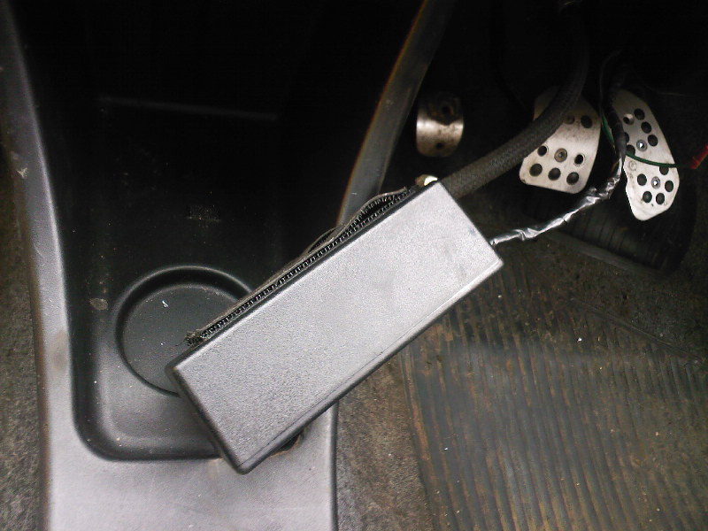

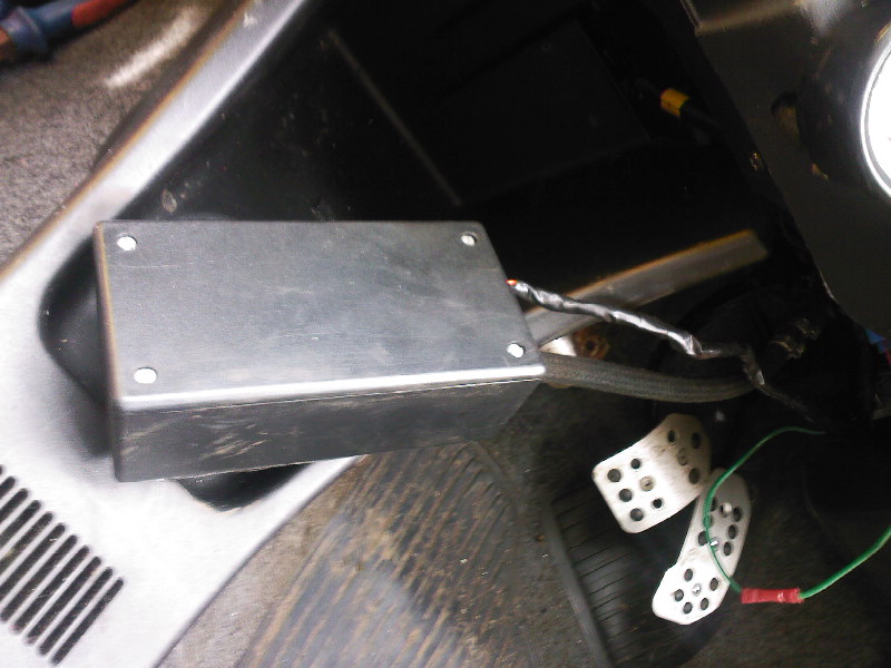

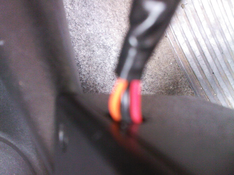

Also can anyone verify if the black box is the MF2? Its got 1xThick Black, 1xThick Red, 1xThin Black, 1xThin Red and 1xOrange cables going into it and when i traced the wires, they go to the 2nd injector in the engine bay..

thats the MF2 yeah and the FCD could be near the ecu plug or near the map sensor little black box usually about 1"
Yea, the first two pics are under the map sensor, i looked all around the ECU and can't see anything there..

Firstly is that a vacuum hose going to the MF2? Looks like it, only other car I have seen like that is Blu's (Jamie's old car) which had been modified to accept vacuum and therefore do away with needing a 2nd MAP sensor as they do not come like this as standard. Look here for pictures and instruction book http://www.turbobits.co.uk/acatalog/erl_aquamist_mf2_injector_controller.html
The FCD is normally one of two types on VAD models, this being an early one i would expect to see a largish unit about 40by55mm made by Superchips that has a little diagram inside to say which wires goes where. theses are normally stuck to the back of the bracket behind the ECU where the two fuses holders are. The later type made by VAD is much smaller and normally spliced into the loom nearer the multiplug for the ECU as i bought a new one which came with instructions to do exactly this. I would try taking the tape of those wires and see if its just a cut and join or its in fact splice and then follow the spliced wires back to FCD. As for FCD this is simple and easy to use http://www.thor-racing.co.uk/Fuel_Cut_Defencer-VFCC.asp
