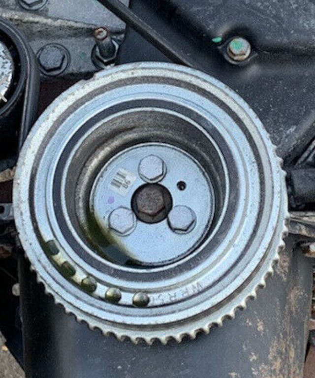

Testing now - not by the looks of it weirdly.
  • 20230201_130935.mp4
    34.9 MB
That dimple has to be correct or the pulley will wobble and the TDC timing notch wont be in the right place. Push the pulley onto the shaft and turn until you feel the dimple connect. Don't fully tighten the bolts until you are sure it's seated correctly.
Righty - turns out I didn't install it backwards, I just broke the one off the new engine trying to hold it still with a spanner while I undid the bolts so put the old one on which isn't compatible with where the sensor is on this engine
The dimple was correct, I'm just dumb :) new crank pulley should be here tomorrow!
