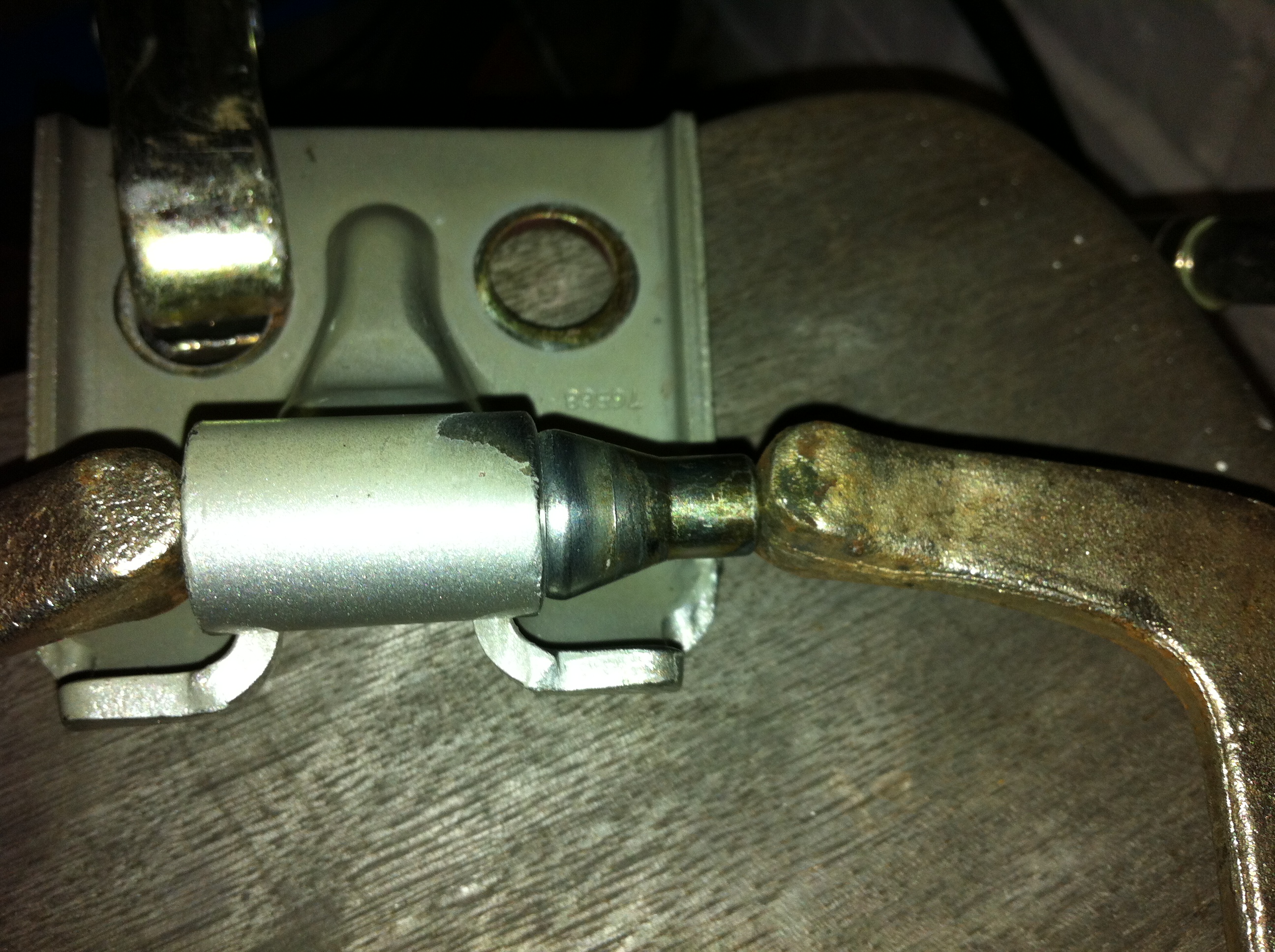

That bit is the pin! Its not just a pin, the door sits on that cone part, i thought it was going to be a simple job, just replace the pin for a bolt or somthing but its a wierd shape. Its threaded in the top of that cone and a 10mm bolt screws in from the bottom in your case, mine was the bottom hinge but its same just upside down.
