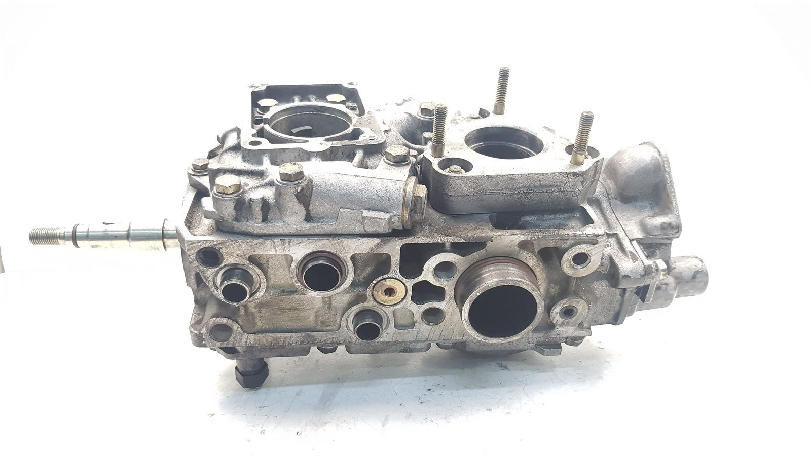

Here is a picture of the whole assembly that bolts to side of your engine and does multiple jobs including oil pump, oil filter mounting , drive for power steering pump, mount for injector pump etc.
On the photo where the three studs stick out to mount the injector pump, slightly to the left and forward of that flange I think is the oil pressure relief valve, but it was a long time ago I worked on them.
