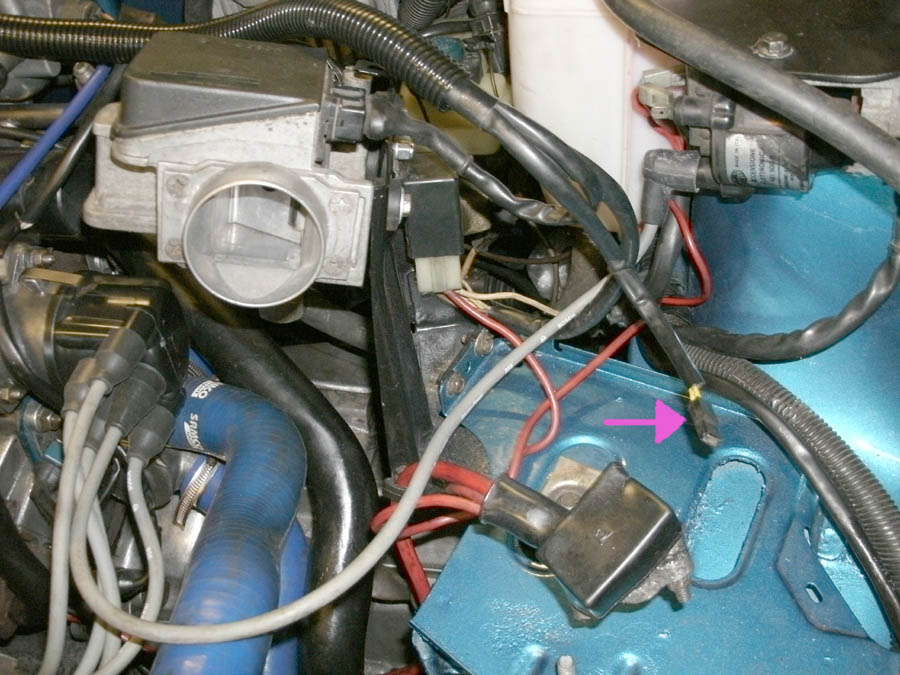

Anyone know what the yellow wire that's on the same branch of the loom as the AFM is for (arowed above)? or rather, where it chould connect. it has two wires (both yellow) and a lucar spade connector just like the ones that go onto the coil.
exactly where should it plug :confused:
Cheers!!

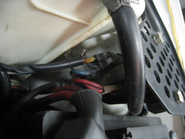

As you can see, it appears that the yellow wires are connected to one of the two negative terminals of the ignition coil (next to the blue wires). The positive terminals have only the red wires (one positive terminal left unused).
Before anyone points out, I can see that one of my ignition coil bolts is missing the spring washer...! What ever will happen next!
