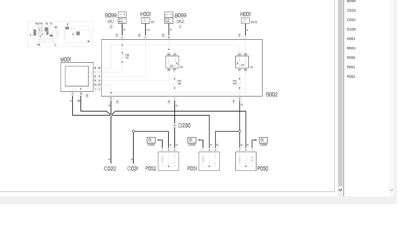

I have no idea if this is correct for your model but the dvd manual I have shows that the 'Rear Current Socket' connects to F33 and relay T13 in the dash fuse box.
On the drawing attached P050 is the dash cigarette lighter, P051 the dash current socket and P052 is the rear current socket.

Thanks Once again guys. One of the issues I see, is my dash fuse box is not the same as the one in these documents - (1st X250 training manual), but is the same as the handbook. there are no fuses or relays missing that I can find that takes power to the aux plug at the back. chasing the wiring, it doesn't go to the bodybuilders plugs, but goes behind the dash fuse box and into the darkness from there...
