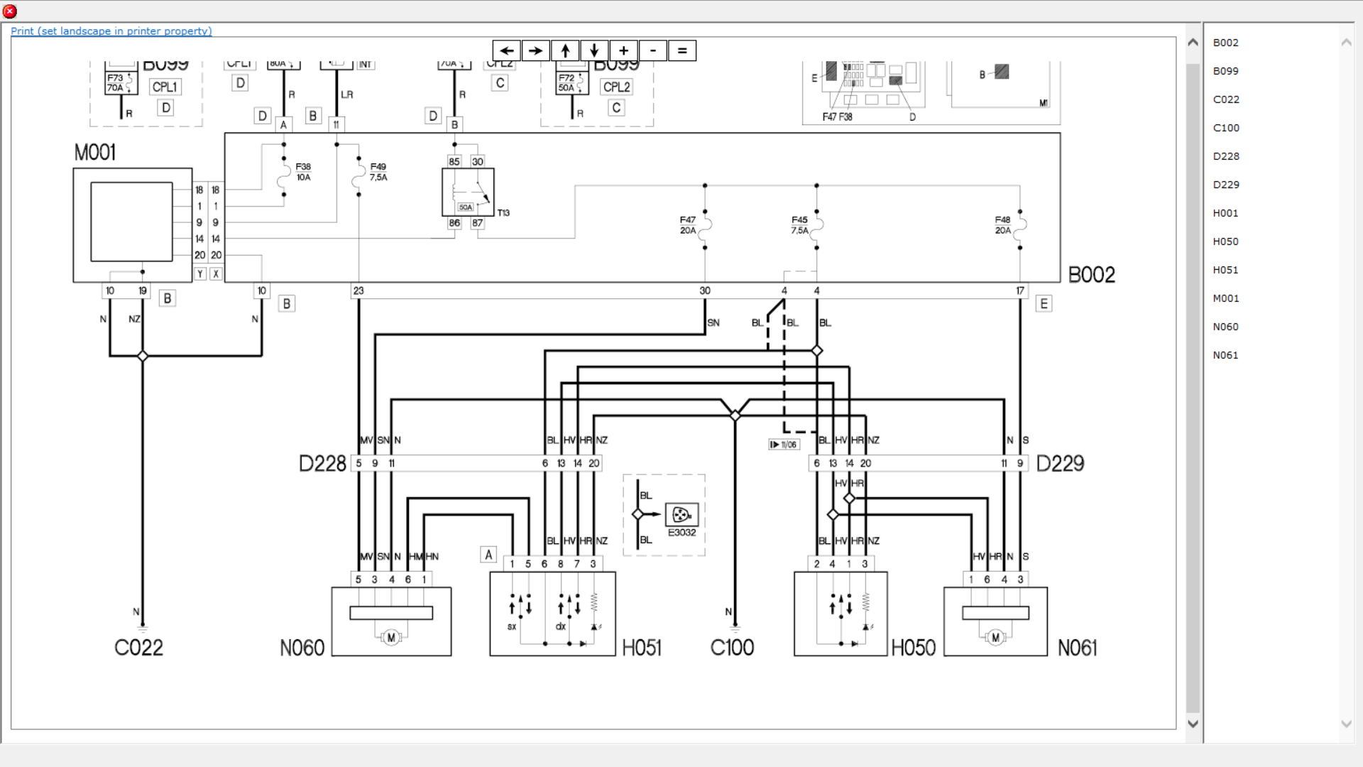

Hi
Attached is the X250 window schematic from elearn.

Hi
