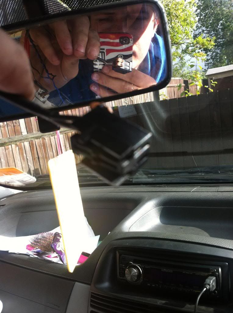

anyway i was hooking up some wires to the interior light so that i can run some leds in the footwell and when i took the light out i found a multiplug not plugged into anything up there so went to test it to see if it was live so gave the tester to the gf (never again lol) and becasuse i had striped the wires back a bit to get to the core she slipped and bridged the two together and i knew it was live as i heard a fuse go but my problem is as i dont know what its for i cant find witch fuse i have blown
the multi plug looks like this if this is any help

The fuse for the interior light is F39 in the interior fuse box (behind panel by right knee)
Bottom row, second one in 10amp.
The first column on the left is spare fuses should you need one.
The other option is F46 which is 15 amp and for the Electric sunroof. Unfortunately I can't see your picture as I'm on my phone!
Failing that, just set your multimeter to continuity, and test each fuse (without the need to remove it) until you find the one with no continuity.
