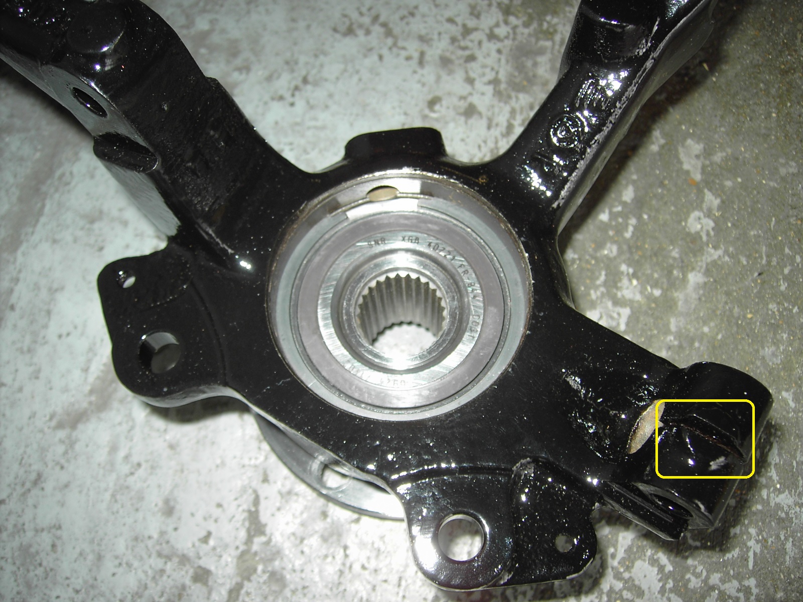

You don't need a ball joint separator. The back of the hub carrier is split where the ball joint pin goes into it. Hammer a wedge (blunt cold chisel or screwdriver?) into the split just enough for the pin to come out.
