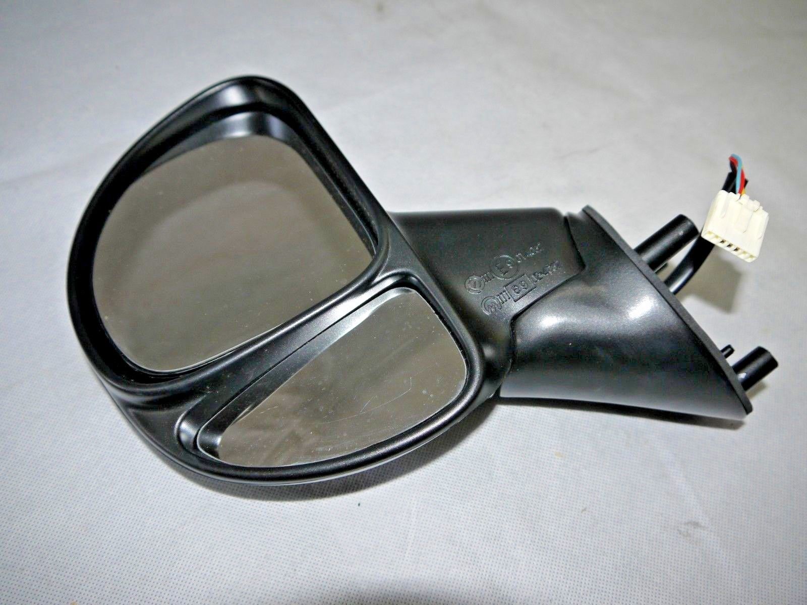

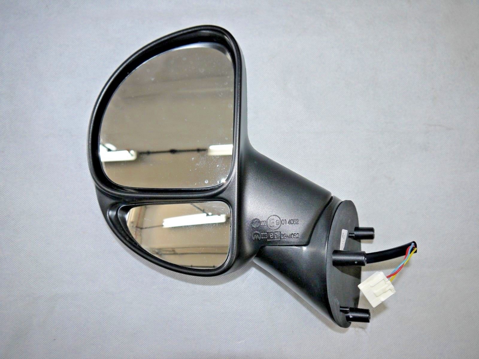

Mirror type 'basic'
NS (passenger side, left hand) mirror: Part number 735264232. Just the blue, yellow and red wires, in a 7 pin plug. As shown in the two photos.
OS (driver's side, right hand) mirror: Part number 735266577. Same wiring and plug as above. No photo :(

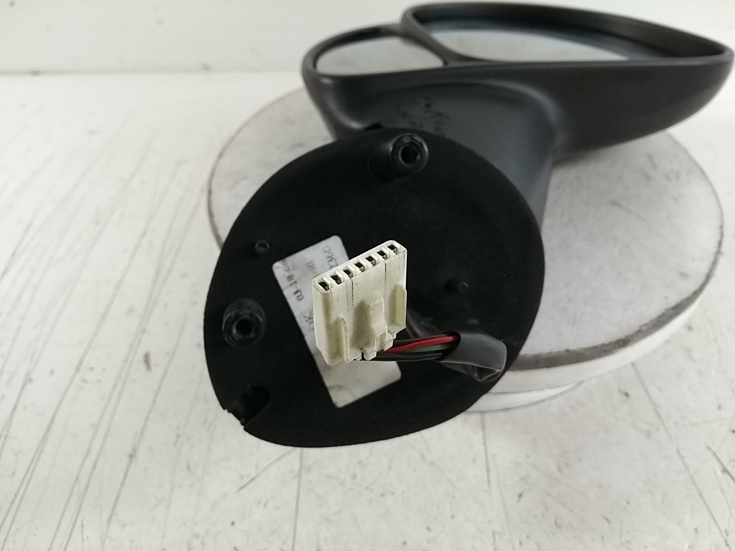

Mirror type 'heated and folding'
NS (passenger side, left hand) mirror: Part number 735264236. Blue, yellow, red, along with the black, white, red/purple striped and brown/black striped wires, in a 7 pin plug. As shown in the photo with the white label on the mounting face. This mirror is from a 2007 year-model - that's a facelift 'squarenose'. I'll leave you to decide if it's the same mounting as the previous photos, but it looks identical to me. I can see no difference in the part numbers listed on ePER for later cars.
OS (driver's side, right hand) mirror: Part number 735282487. Wiring and plug as above. Two photos of a new mirror. In the photo where you can't see the two mirror surfaces, not the small, flush circle on the shell, at top left of shot. This is a blanked whole for the external temperature sensor. This mirror type can be retro-fitted with the sensor, by taking the sensor and two purple wires that run to it from your old (broken!) mirror, but you'll need to fudge the wiring as the connector is only 7-pin.

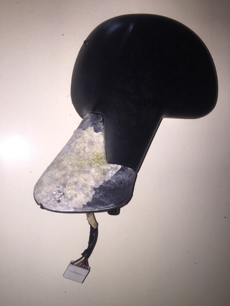

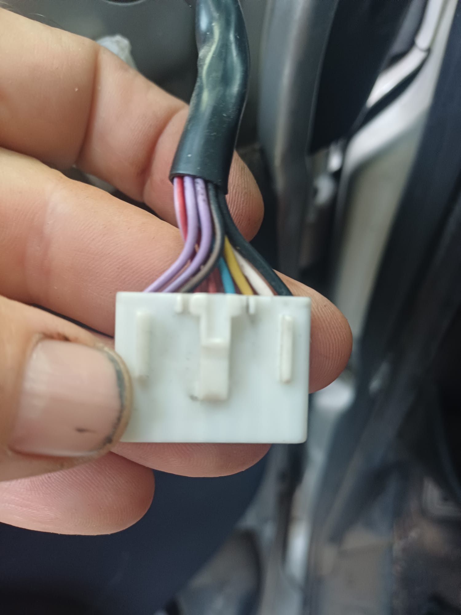

Mirror type 'heated and folding, with climate control'
OS (driver's side, right hand) mirror only, in the UK at least (I'm not sure if the external temperature sensor is in the LH mirror on LHD models): Part number 735266578. All of the wires in the previous post are there, together with two small diameter purple wires, for the external temperature sensor. Note the little nipple at top left of the first photo - that is the sensor. This type of mirror is only used on cars with climate control; for the round nose, that will be the ELX trim level and for later (squarenose) models, the Elegance and possibly the Dynamic Plus trim spec. Fitted with a 9 pin plug. Three photos of a well-used one from a roundnose:
