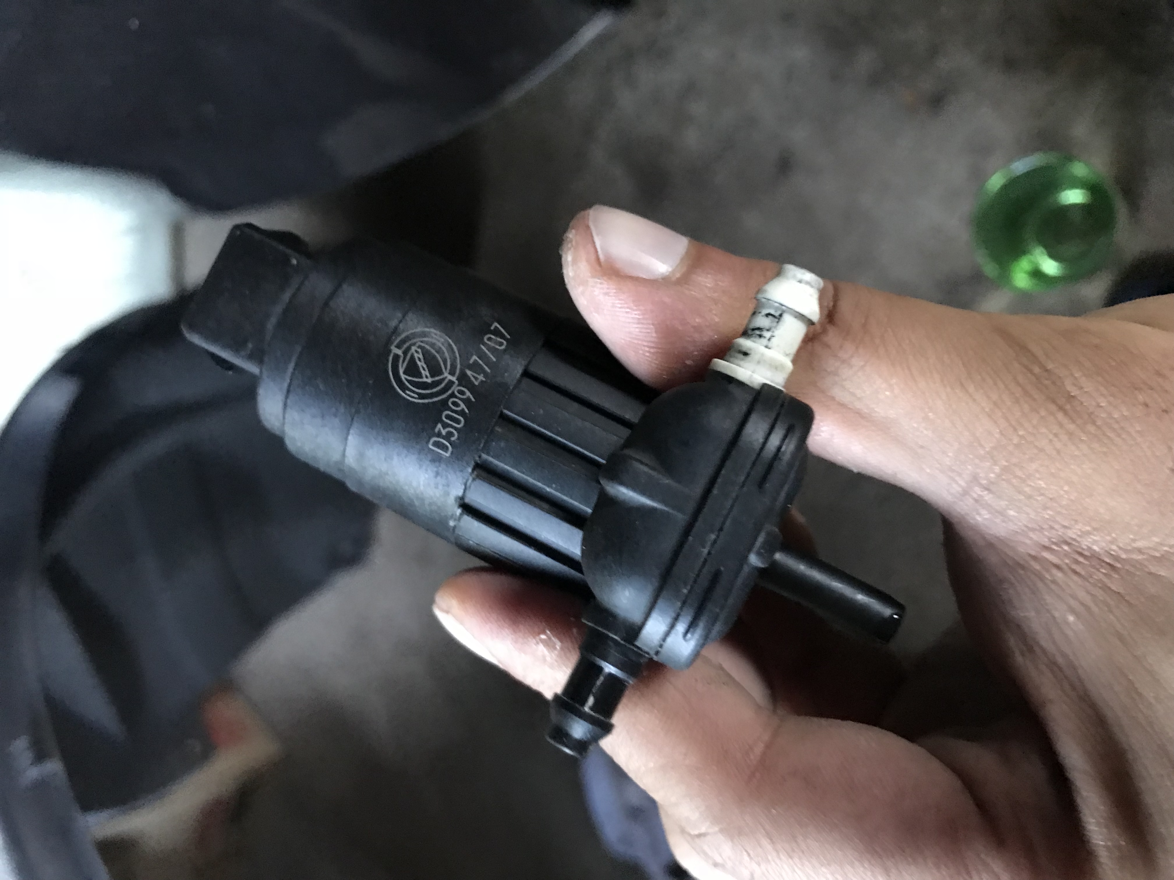

Hi,
I was looking for a replace washer pump as I believe my present one has failed(no sound from motor). However, I have failed to find the exact replacement anywhere online(I’m from Australia). I saw this link and it says that it fits fiat bravo. Could anyone help me if I’m the product is compatible with my car? It’s a Fiat Bravo 2008 1.4 tjet.
Thanks
Hi,
Do you want me to remove the black plastic case and show you what’s inside?
Just checking and apologies if you've done so already... but have you checked the fuse for the washer pump? :)
According to the manual, it should be a 30 amp piece located at F43 (behind the glove box)
