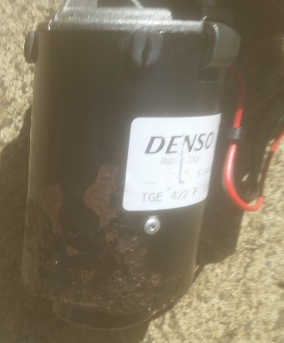

I am in Australia, and the info on my wiper motor is DENSO TGE 422 P 12V

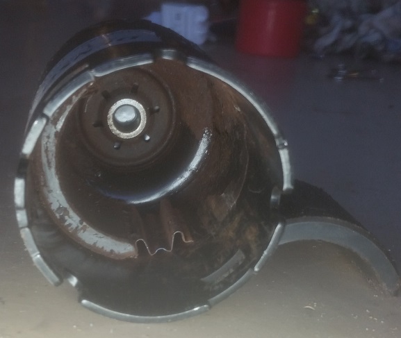

At home I removed my wiper motor, to find that the bottom was all rusty, and that the bottom spring type separator, between the two permanent magnets, had rusted away.
This had allowed one of the magnets to fall out, and attach itself to the rotor
The only Fiat commercial place in Western Australia does not have one on the shelf, and they say that it has to be imported from Italy, so I may as well get it myself
I made a new separator (unsure of the correct name), from what is called a bull clip.
A spring steel clip, you use to clip pieces of paper together.
After fitting it, I used an aluminium pop rivet, to keep it in place.
My wipers do now work, but… they will only keep working until they fail, as it was just a bodgie job to keep me going.

Picture #1 is top left then clockwise
#1 is original spring spacer, the second spacer was rusted out and just not there, that is why the magnet fell out
#2 is what I made a new spring spacer from
#3 is new spring spacer pop riveted in place to hold both magnets in place
#4 is everything reassembled showing outside rust and pop rivet
