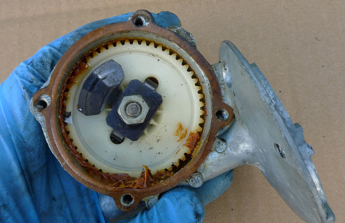

With all our wet weather, my wiper motor gave out yesterday. But after a good clean, it's back to running great.
Since my parking mechanism is different what Chris shows in his photos, I thought I'd just post what mine looks like (It's off a 500F). Mattsdad indicates that Matt's looks like the one I have in this other useful post:
https://www.fiatforum.com/500-classic/314059-fiat-500f-wiper-diagram-operation.html
The wiring in my wiper is just a little more complicated than what shows in Mattsdad wiring diagram but it does describe how the motor gets power and parks the wipers after the switch is thrown into the off position.
