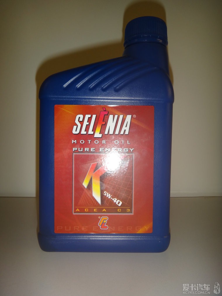

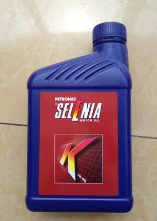

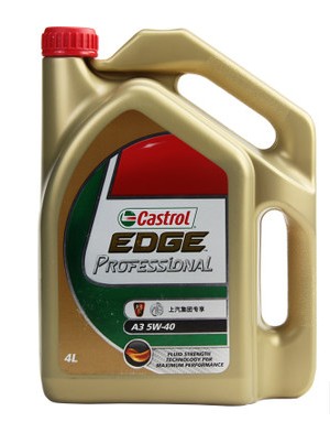

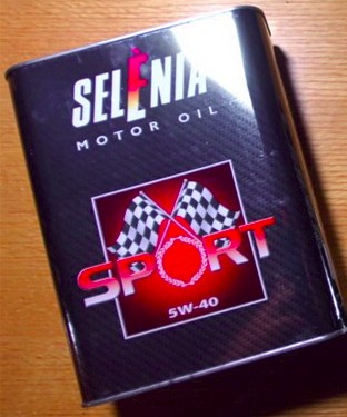

1.SELENIA K
2.SELENIA K.P.E
3.SELENIA SPORT
4.Castrol EDGE
5.HELIX ULTRA
6.Mobil 1
one more question:Is the fuel filter need to be replaced?
You have to replace OIL filter whenever you replace oil !!! Oil filter costs like 5EUR and is a vital component which keeps your engine from malfunction. Any SAE 5W40 or 5W30 synthetic based is OK, recommended is SELENIA K P.E (5W40) or SELENIA WR P.E. (5W30). I always use Selenia WR in T-JET as it is not a thick as 5W40 and comes to all parts of the engine ASAP. From the list you wrote I would put in SELENIA K P.E 5W40 since you did not write that you can buy 5W30. I used 5W40 before but Fiat changed the recommendation and now they recommend 5W30.

The recommended oil is KPE or ACEA C3 (this is important for warranty and for DPF or TWC (T-Jet case)).
But ACEA Cx oils have less TBN, so it is important to change oil (more often) at least once a year and/or every 10 000km.
Other oils are OK, but why do you want to change brand/type oil?
