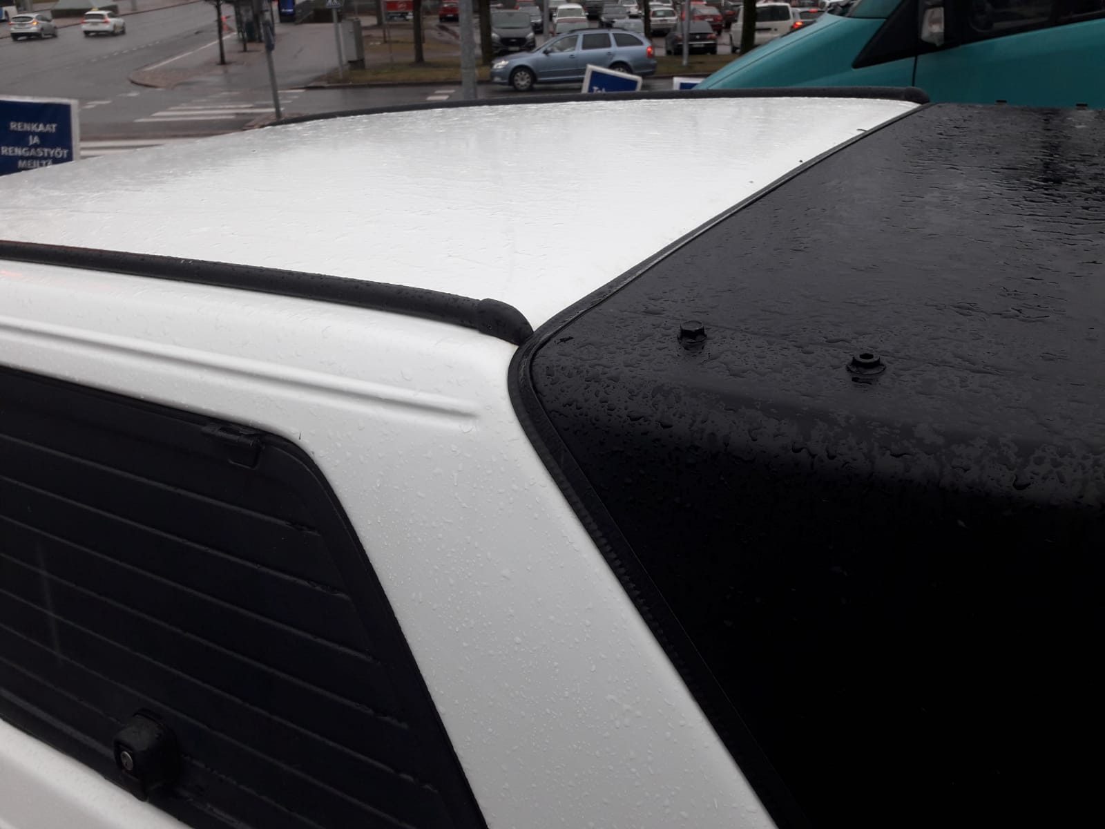

I am a owner of classic fiat panda 4x4 van and looking for proper roof racks. Bought one set of roof racks from Summit and those were no good for anything. Where to get some decent ones?

i dont think you can buy them. my roof rack involved welding threaded sockets on to my roof most people don want to do that but i wanted somethin sturdy

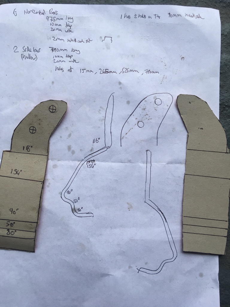

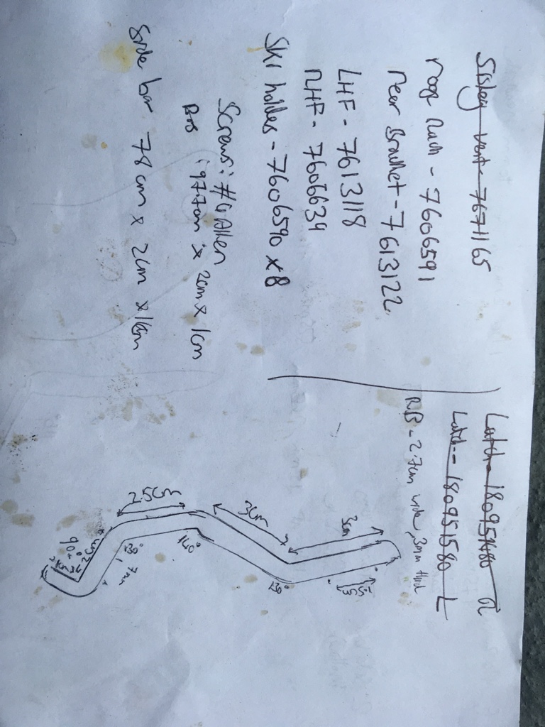

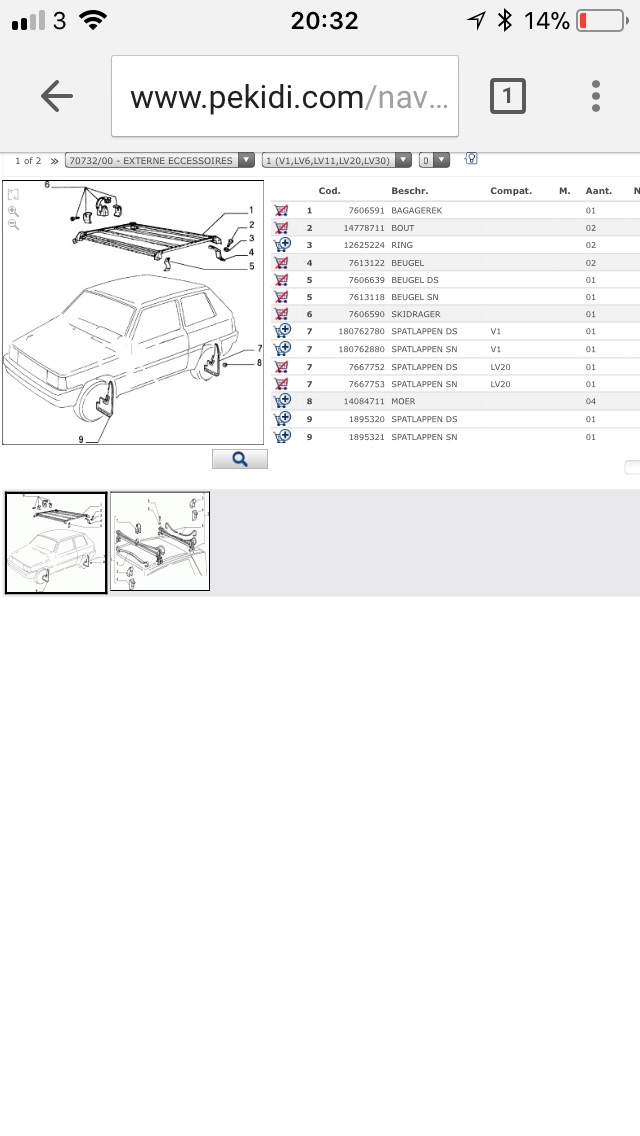

Sisley type roof rack? No hole drilling in the body then :)
Myself and a couple others on the Facebook page are working on making a guide for fabricating a Sisley roof rack, provided you have the 4 plastic cornersView attachment 185592View attachment 185593View attachment 185594
