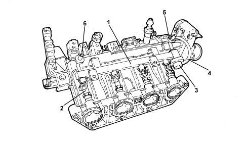

I need help. Can anybody tell me where the
Fuel Pressure Regulator is located on the Fiat Bravo T-jet 120 hp
:life:
Cheers
Khaled
I think this is what you are looking for:
The fuel manifold, which distributes the fuel to the injectors, incorporates the seats for the injectors and the differential pressure regulator.
The fuel supply and return are carried out through rapid attachment.
The pressure regulator ensures the right fuel supply pressure in ratio to the air chamber pressure.
199004582.image
1, Fuel manifold
2, Injector
3, Differential pressure regulator
4, Air pipe
5, Connector for fuel supply quick coupling
6, Connector for fuel return quick coupling to tank
