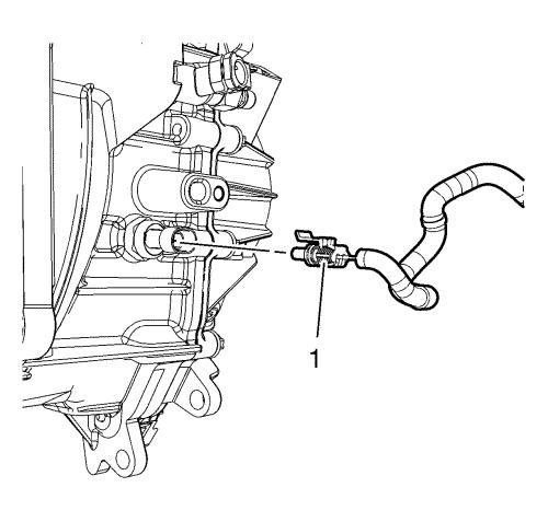

Hi Technor just read through this thread it must be be a pain not being able to back up! we recently got back from a weeks holls in Devon and there are many car's in Devon are allso unable to reverse sory i digrese. I think it might well be worth disconecting the reverse switch on the gearbox as this tells the cars brain that you have selected reverse gear if it does not know then it should not turn off the engine. It is I think under the battery tray on the front of the gearbox it has a lift up tab and pull it out.No back up lamps but if it works at least it will reverse.:)
