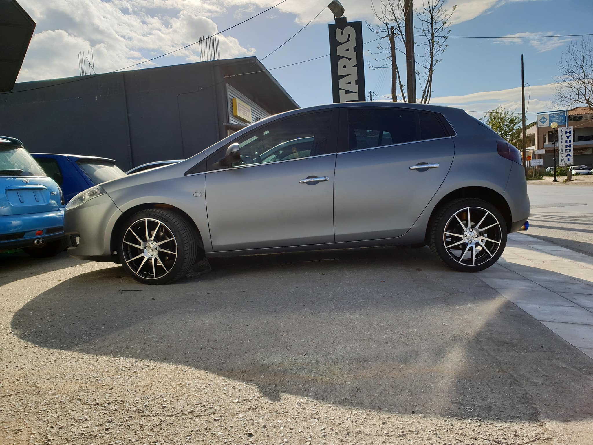

If your willing to use wobble bolts it widens your variety by quite a lot. They give you that extra few mm so you can run 4x100 alloys. I used 4x100 alloys with wobble bolts for a year with no issues at all.
Just be sure to use spigot rings.
Hope this helps ?
These were 4x100
