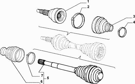

With the wheel off, the CV gaiter should be visible behind the brake disc. It should not be oily/greasy on the outside. Wipe the gaiter and examine it for any holes or splits. If caught early a new gaiter and some grease is all it needs. (Item 3 on the pic)

Excellent thanks! Yes there was oil/grease around it so guess there must be a split in it then and hopefully caught early enough as I only had the wheel off last week to try my new 17" wheel on and there was no oil/grease at all anywhere then.
