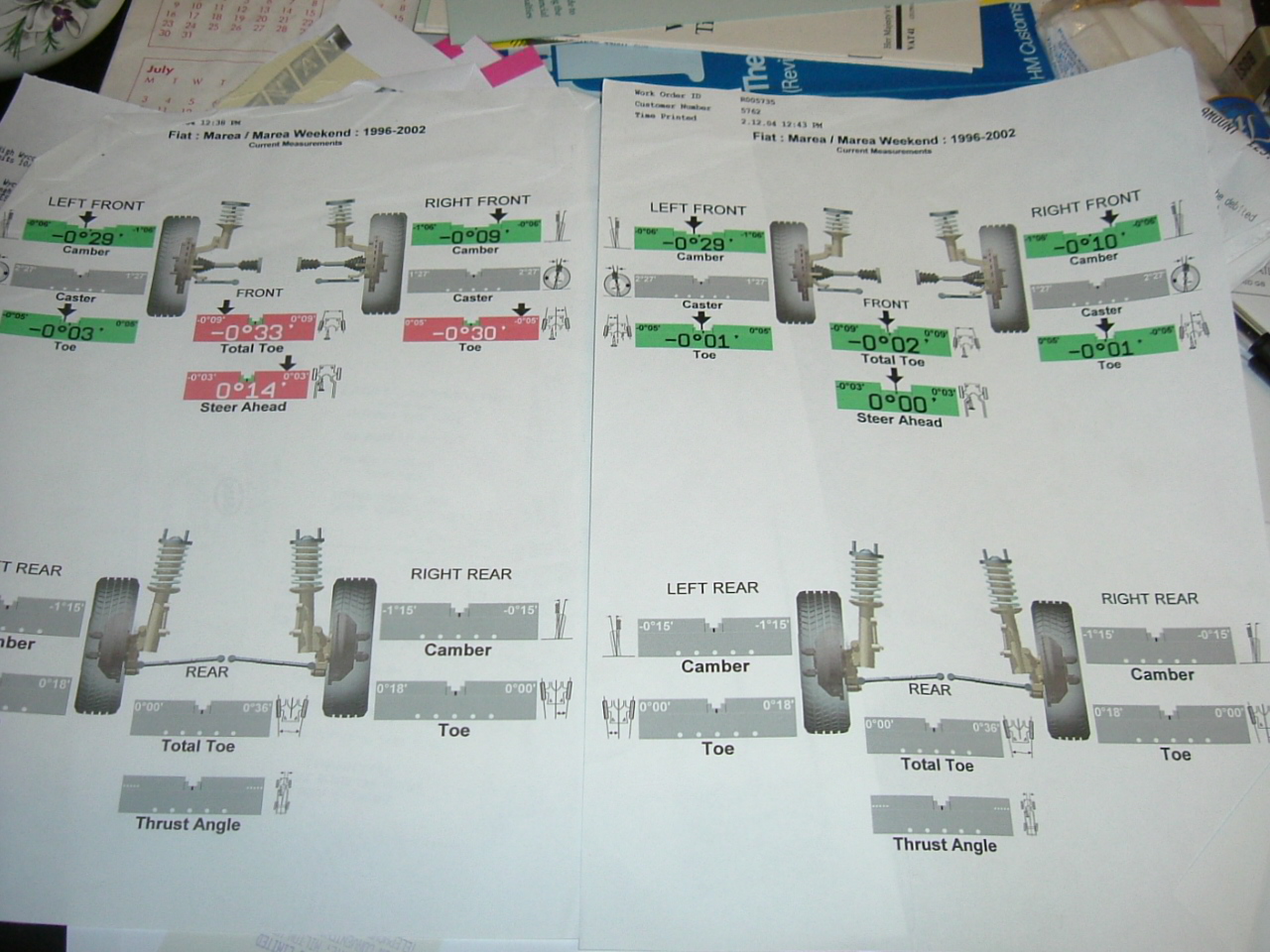

Look what I just found, before and after

Ha, thats what I want.
So is that achieved by adjusting just tracking rather than the attempt at 4 wheel alignment I ended up with? Confused.................again.
Tracking is the ONLY thing you can adjust on the Marea without spending big money on adjustable top-mounts which may not be road legal.
The idea of 4 wheel tracking is to get everything going in the right direction so it's not a total waste.
Thats adjusting the tracking and only the tracking using a 4 wheel aligner. It clamps to the back wheels and sets the fronts to that. The backs are not adjusted, you just measure what you have got, then set the fronts to the best achievable. It works well. Why the castor improves I dont know, maybe tracking and setting steer ahead helps it?
