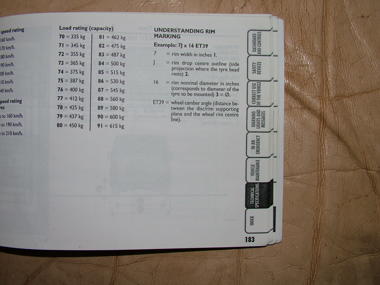

There are many variations of wheel depending on the load it was designed to carry etc.

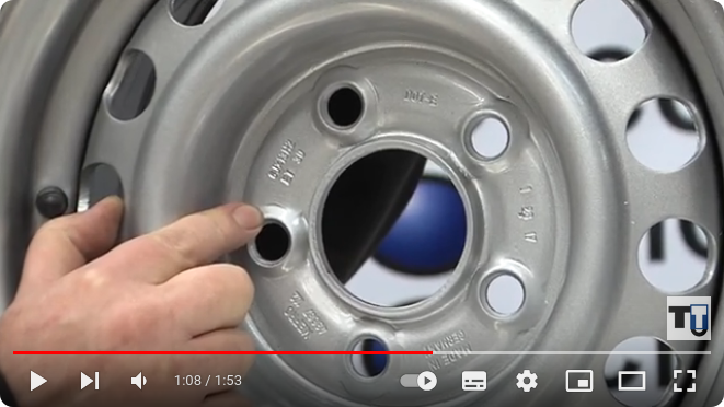

If you have a look at your spare wheel and give it a good clean there will be a series of numbers etc. that identify it.
You may also widen your choice if there is a similar van badge engineered as a Citroen/Peugeot/Renault etc.
Re wheel choices as an example I have a long wheel base Fiat Scudo, the handbook gives these options.
Is that number visible with the tire on the wheel or only when the tyre is removed?
