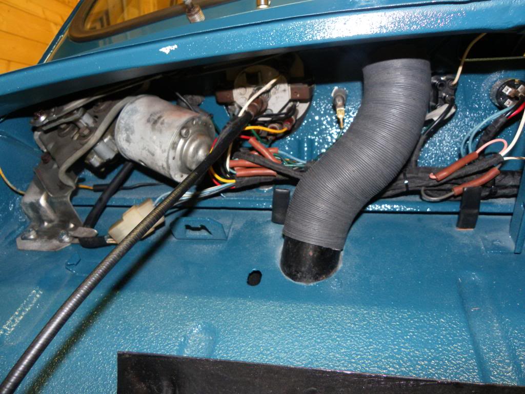

Gee really, as difficult as that to remove? I was hoping it would be easy, just an unplug and the inside would be something like this pic:
(not such an easy task or visually pleasing result to fill the big hole in the dash I guess)

It would involve stripping the entire dash - lots of welded repairs and then lots and lots of masking before painting and rebuilding
I'd say an expensive task

Here's the bonnet side of the dashboard. Definitely a great big cut out for the tacho. I doubt I could repair that satisfactorily, is replacing the whole dashboard a huge job?
If you could find one, replacing the whole dashboard would be a fairly major job.
Most people with resonable welding skills would be able to make a fair attempt at replacing that disc of sheet steel and filling any additional switch or warning lamp holes. I would find it impossible to do an invisible repair but a thin skim of filler would make the repair complete.
In both cases you would be removing the same amount of fixtures and wiring so that you could do the work. That would include the windscreen and the fuel tank.
On the Fiat 500 this is probably going to be the least of your welding repairs.:D
