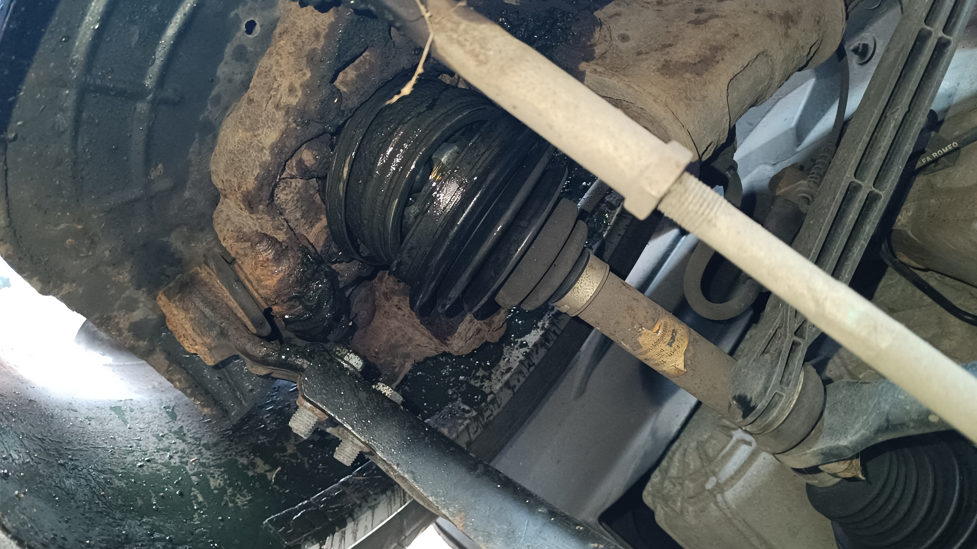

My 500X is knocking badly, so i just took a look and found this...
What is going on here?

The question is how lucky you are, is it it just a case of slap a generous helping of CV joint grease all around the inside part of the joint and fit a new boot or is it a case of a new CV joint?
Usually this depends on how long it has been neglected for.
Although I am sure many drivers have gone to the Dealers and come away with an expensive bill for a complete driveshaft.![]()
Righto, thats helpful, thanks.Looking at your first photo the clip does appear to have come off the boot.
So if you take the wheel off, put the steering on full lock, put your "marigolds " on, then get a big handful of that CV grease from your tub and work it in past the knuckles of the CV joint turning the wheel and working even more in so you know that the actual joint is well lubricated, then straighten the steering, slap a little more of the grease in , get rid of the old useless clip, slide the CV boot back into place assuming there is no splits or other damage to it, after wiping any grease from the area the boot is going to fit over the joint, once it is correctly in place get a good new clip and securely fit it holding the CV boot on tightly.
You can use the plastic ties but only if you have the proper tightening pliers to match, I have some metal strapping that I can use , but other than that there is the proper metal straps that come in a CV boot kit along with the grease, however again you need the proper pliers to secure the metal strap otherwise the boot will slide off again with same results.
