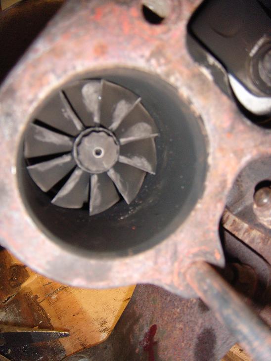

Its an IHI turbo so a T25 is really out of the question, or too much work anyway. Can you take a photo of the turbo compressor and turbine blades, or at least measure the compressor inducer. I've been told they fitted a VF10 compressor but I don't really believe it.
Compressor fins are 56mm exhaust side is 46mm. Hope these photos help.

Yeah that is a VF10 mate! Way bigger than standard. I would not upgrade it. You could try a larger turbine housing. 12-r off a mazda or similar, it will make a difference but it will also give more lag and you'll need to fab a new exhaust. This turbo should make a lot of power.
