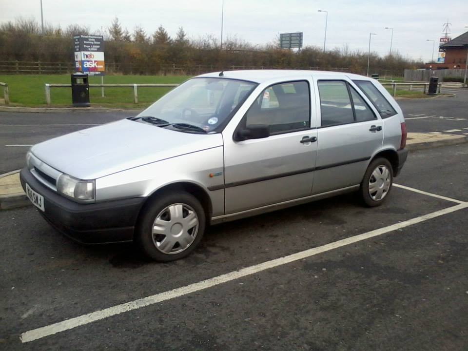

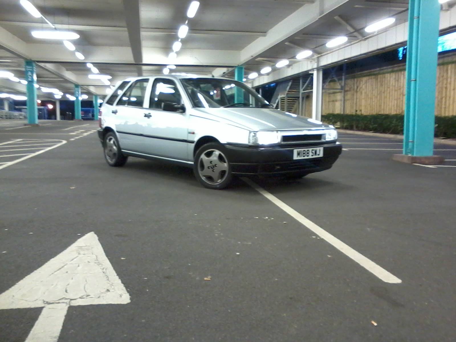

Well, here's the Tipo before and after!!
Well TBH they don't look terribly different, maybe greyer and shinier!
They are ideal for the car, set it off really nicelyu and when balanced and tracked you should have a fine handling machine.
Silver Tipo with the nice blue check interior and Sedi alloys! Lovely...
You need to uprate the crappy old speakers if you haven't done it yet, then you're sorted.
I was looking at some speakers for it, as I'd put some new ones in my Uno last year and was amazed at how much difference it makes!!
Not that I blast out loud music, but maybe something I'll change at some stage as the speakers are a little tinny!
The wheels aren't too dramatic, but thought that the grey complimented the silver a little better than if they were just silver!!

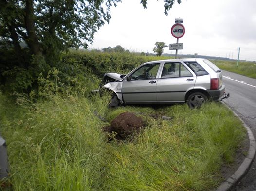

I found the ride the ride a little too harsh with the lower profile tyres, however before I had any chance to look at that me and the Tipo was involved in a car accident.
Which was caused by someone else, who decided to make off!!
Anyway the short version is, in trying to avoid the other vehicle I collided with a sign and the car is now a total write off :(
Thankfully I'm ok and I could walk away, a testament to the strength of the car.
But sadly my Tipo is no more, so on top of that I have a large bill from the recovery company to pay.
Plus whatever claim on my insurance I may get from the council/ highways for the sign.
Just extremely angry that someone can cause a road accident, then make off without a thought or care to what harm they could of caused.
But what's done is done no point wasting time being angry, so to try and recoup some money I've sold the remains of the car onto another person who will salvage what they can for their Tipo.
