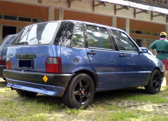

hi dunc,
mine using 14 and rubber is 185/55/14, dont have a problem lowered it about an inch. i wanna go 15" but the weight keep set me back, perhaps it is not the case if i'm running a turbo :yum:

hi dunc,
I really thought that was a 5 door Tipo until I really stared at the picture!
