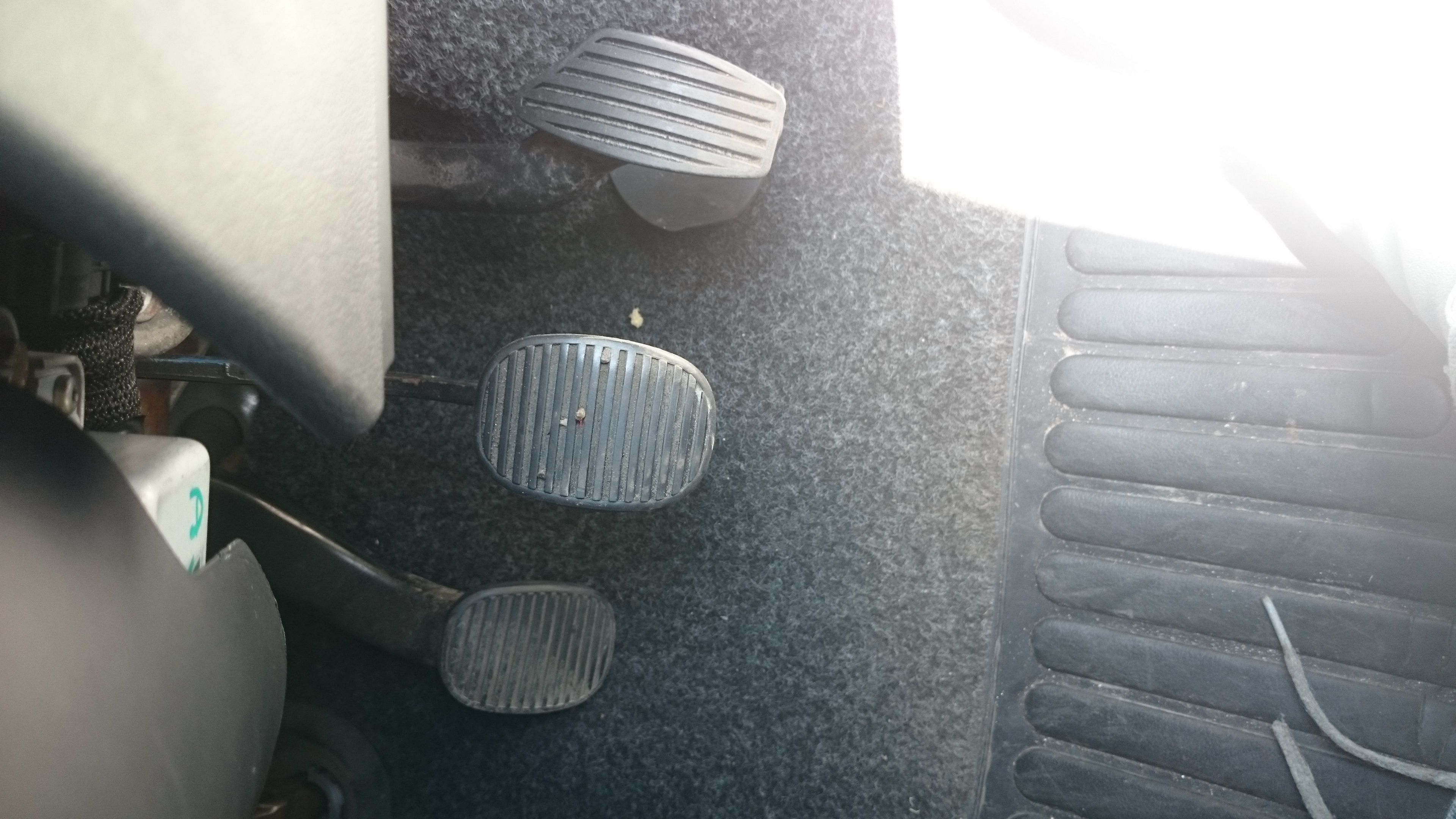

This was it .Clean stuck down. He said that a pivot was sticking and that they'd adjusted and lubricated it.
It felt better for a short while .But on the next outing it felt a bit off .As a comparison my van has done roughly the same miles (36) and the clutch is soon and moves fluidly. Mine doesn't. It's kinda stiff.

ePER, the parts lookup system suggests it is a hydraulic system.
Pedal sticking down is not usually due to the pivot, so lubricating it did nothing. I don't believe there is anything to 'adjust' at the pedal. It either needs a new master cylinder, or if there is a mechanical fault with the clutch itself, a new clutch. Anything less is just hoping!

I said id ask my mechanic for a more detailed explanation of what he'd found. Drove off.. Within a few miles.... Whilst entering a multi story car park...clutch was sticking again.
Rang him up. Told him the issue and that I have photographic proof of it sticking. Put my foot down (pun not intended). He's having it back to look over properly and hopefully he'll give me something from his lot to go home and back in. I'm not getting the train...
