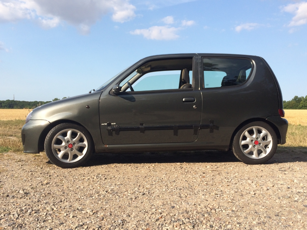

Centojosh inspired me to get the same set of springs, though without the Weitec shocks as my car's on Yellow Konis. The Weitec springs have replaced a set of 60/40 ones, which were STIFF. The seller advertised them as 40/30 springs but both the box and included documents stated 35/35.
Funny thing is, the drop looks the same as centojosh's!
https://www.fiatforum.com/attachment.php?attachmentid=142594&d=1408792584
I've been over numerous speed bumps, gone theough various potholes, just finished doing 230km on the motorway and have been thrashing it (and driving normally) through roundabouts and many of my favourite 'test-areas'.
Comfort-wise on the road and over bumps, uneven/rippely tarmac and small potholes it's truly comfortable in cento-terms. The car is comparable with stock Sporting springs to some extent, though it's obviously a firmer ride.
In normal driving situations the car can be used as one normally would. The maximum speed over bumps is affected, but very little!
Going over a sharp-edged curb or something similair is punished instantly. This and big potholes are the only points were the firmer setup instantly punishes a daily driver.
The car feels planted through fast corners, as well. There is a catch, though! The rear is a bit twitchy when going at 100kph+ in strong crosswind. I suppose this is mostly a consequence of the rear sitting taller than the front. Add to that my tires which are sort of tall and stock Sporting width.
