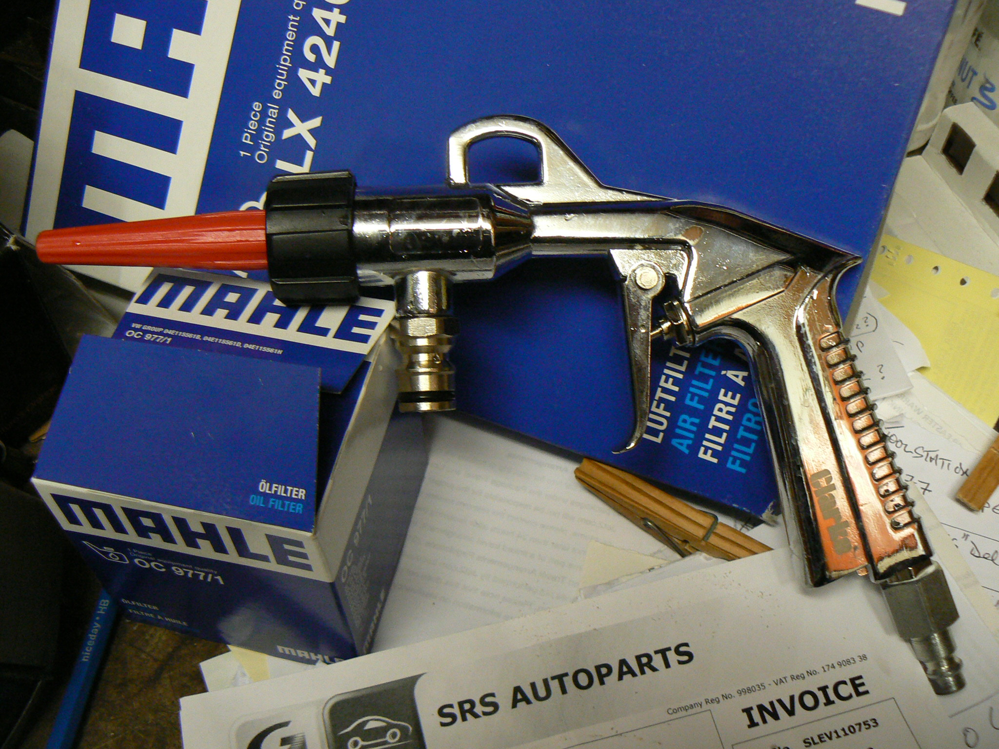

When we bought Becky (our 2010 Panda Dynamic Eco) a couple of years ago I learned, from this forum, about their liking for rear axles corroding. Right away I thought, Well Becky's doesn't look too bad, I'd better do something about protecting it. Then I did nothing! Some time before Christmas I was in Machine Mart buying grinder discs and other stuff when I remembered reading about the Clarke Water Wash Gun:
https://www.machinemart.co.uk/p/clarke-cwg2-water-wash-gun/
I liked the look of it despite having read some pretty derogatory reviews about it. Well, I thought, I'm only going to wash the dirt off the axle and then coat it with something (maybe waxoyl, maybe chain saw oil, don't really know yet) so this has got to be better than a hose? I'd really like a pressure washer but don't want to buy a "cheapie" and can't justify a quality (Kranzle) one. Anyway I bought one although I did wonder if something so cheap could really work. Then it lay about on my workbench until today. Here's the actual one I bought:
Connected up my large bore air hose and water hose (standard connectors just snapped on)

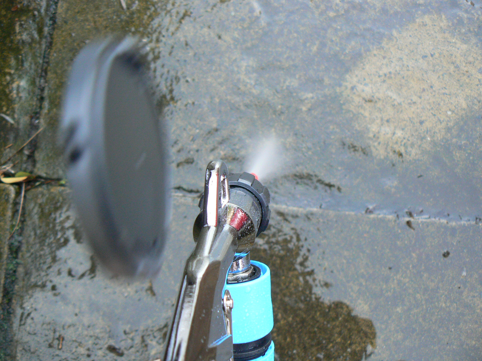

Then turned on the water tap. Oh, that's not good, just a dribble of water. (We have good pressure, around 6 to 8 bar most days being as how we are almost at sea level). I had connected the air hose direct to the air receiver via my large bore air hose so it was at 125psi. Pulled the trigger and a very impressive jet thundered out the nozzle. unfortunately it contained so little water that it had no force (rice pudding skin comes to mind!). Well, looks like the reviews I read were right I thought to myself. Trouble is it's just not getting enough water. Wonder if I can bore out the water jet? Then - stupid me - I noticed a little plus and minus mark on the black fitting holding the nozzle on. OOOH! thought I. Yes, you've guessed it, It was set at minimum! I screwed it round towards "plus" for about two turns - till it stopped - and tried again. Now that's better, lots of water now, still less impressive than my ordinary garden hose though?

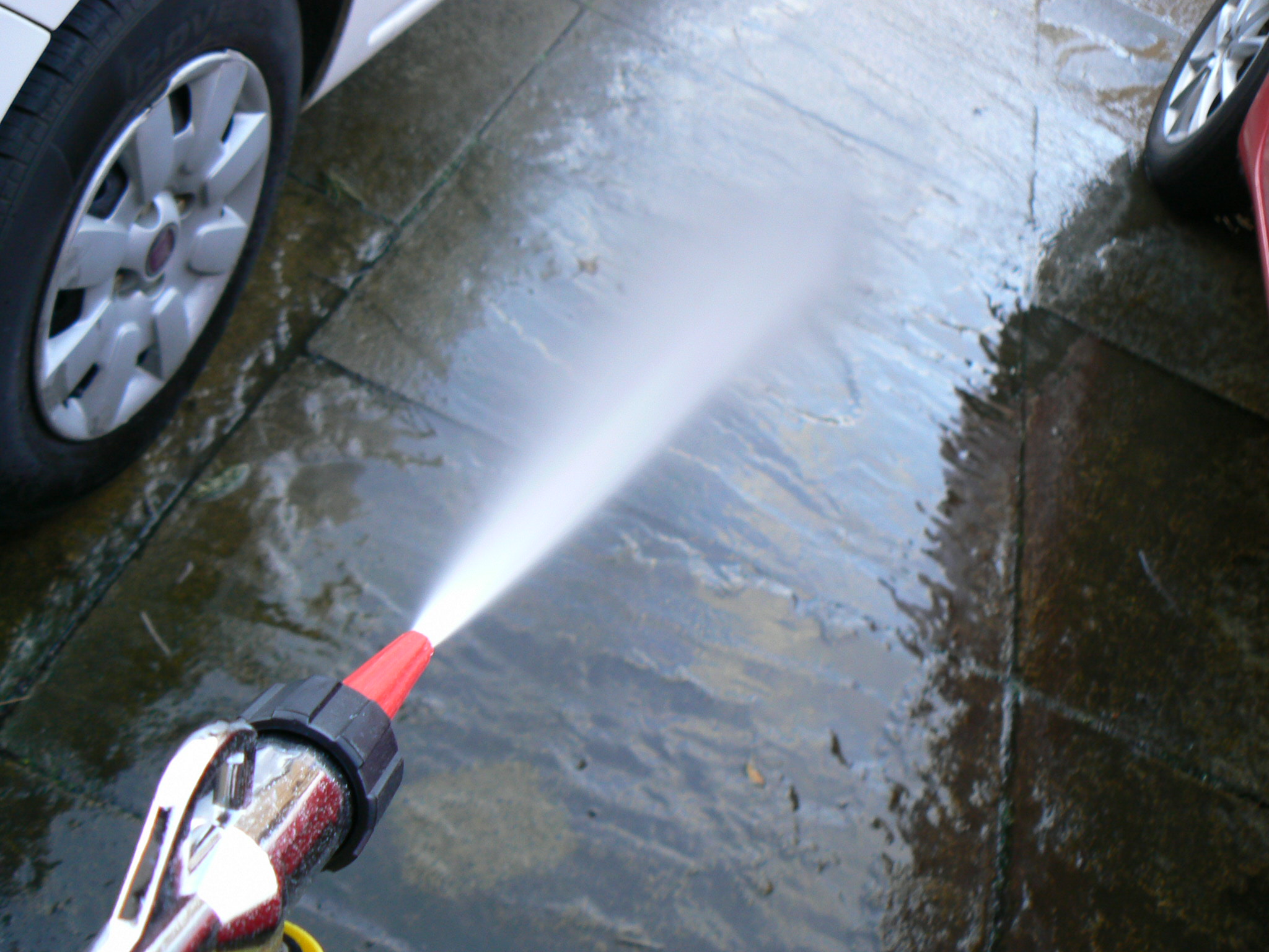

Wow! Now that's what I thought it should be like! Wonder what it would do to my dirty slabs. I wasn't expecting it to clean like a pressure washer but just look at this:
Pretty good eh? Not quite in the pressure washer league but for just over a tenner I think that's fantastic and is certainly going to do a really good job of cleaning up Becky's back axle. Probably ought to cut the pressure back to the recommended 90 psi though? Damn it, now I really don't have any excuse for not getting stuck in have I? Unless, maybe I should wait for the warmer weather?

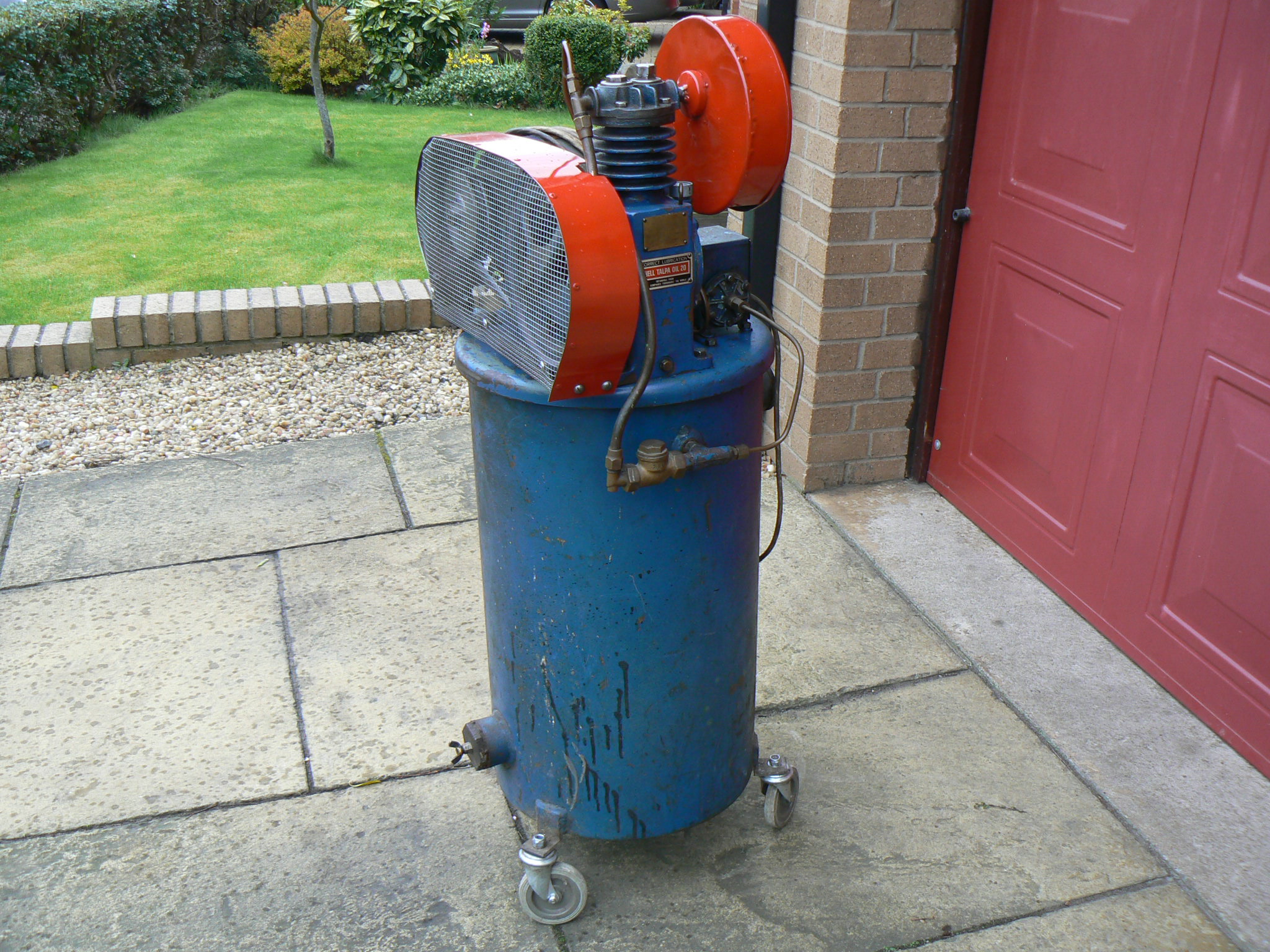

Yup. There's a lot of ignorance/lack of awareness about compressors. My preference is for a nice, as big as I can afford, slow running, belt driven jobbie. generally a compressor like this will be relatively quiet running and have an excellent duty cycle when compared to a similar direct drive (motor and pump in one unit). I recently saw a very interesting sight at M.M. whilst waiting at the counter. A chap came in with a badly burnt out small direct drive compressor unit - actually leaking oil on the floor. When he departed I made some comment and the sales chap told me that was the second one he'd replaced for the chap. He commented that the fellow was almost certainly running something with high demand on it so that the motor was running almost continuously and these small "hobby orientated" machines just couldn't do that. He predicted that the fellow would blow that one up within the week and this time he was inclined not to give him another.
This is the unit I have now, it's the Wolf Dakota 3hp 14cfm on a 90 litre reciever. The newest version is coloured blue but is the same compressor.
Does everything I want it to, Both my air impact wrenches, air hammer, suction paint spray gun (not used often now cellulose is so difficult to get) chassis wax injection gun, etc.
Before that I had a tiny compressor - I would guess maybe 2 or 3 cfm but on a nice big tank.
It worked quite well in short bursts but took about 10 minutes to then refill the tank. Very annoying when spraying!

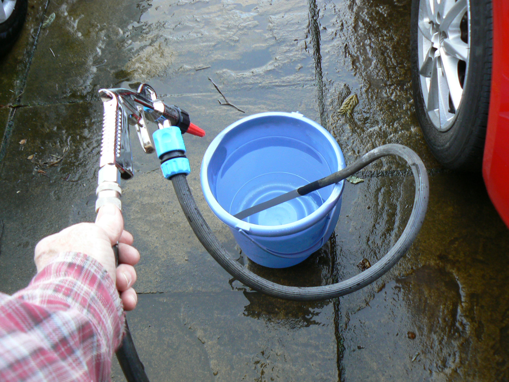

So, today I've been messing about with the water gun and things turned out pretty much as I expected.

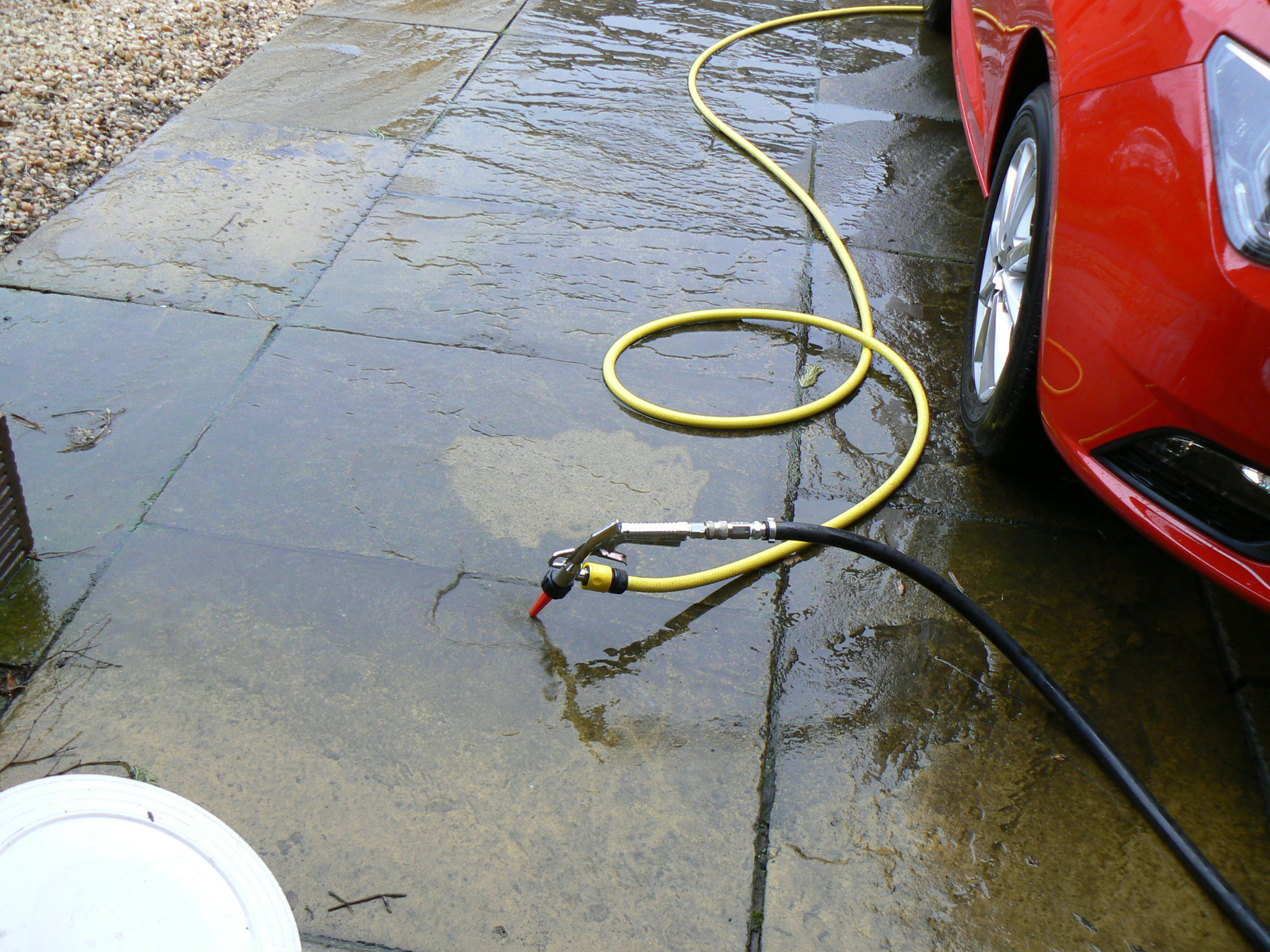

I started off connecting it up through my pressure regulator/trap. So about 50 ft of 1/2" (13mm) bore hose to the regulator and then about 16 ft of 3/8" (10mm) bore rubber hose to the gun. regulator set to 90 psi with the trigger pulled. I then found some standard 1/2" bore garden hose just under 4 ft long and fitted a quick connector to the end - to act as the siphon pickup and filled a bucket with water.
With the siphon hose in the bucket I pulled the trigger and --- well, pretty much I got a Scotch Mist! impressive "windy" noises but not a anything of much use

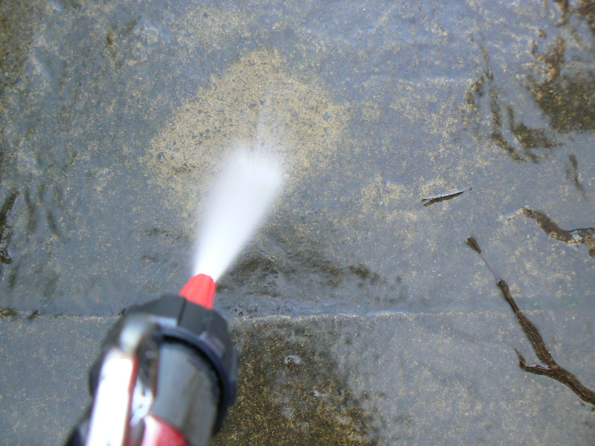

I turned it on the slabs but it didn't really even "tickle" them. The cleaned rectangle on the right was done with the garden hose connected - see PS at the end of the piece.

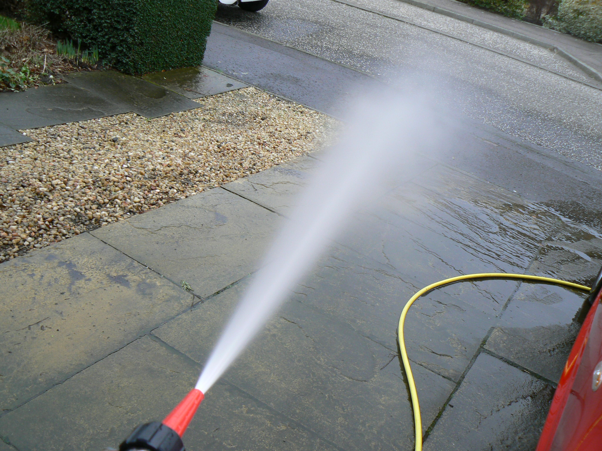

Then, just in case turning the air down to 90 psi - remember when I tried it the other day I was running it through just the 1/2" hose with no regulator in the system at the receiver pressure of 125 psi - I coupled it up to the mains garden tap again and pulled the trigger. Now that's more like it.
But how will it work on the slabs? will the lower pressure mean it looses potency?
Great! it seems to work just as well as it did on the higher pressure! So if we look at this
The cleaned rectangle was done with the water supplied via the tap and the bit to it's right was "attacked" with the siphoned water supply. The conclusion has to be that unless you can run this with a good flow of mains water it's pretty wimpy. But, get enough water going through it and it becomes quite a potent piece of kit. And yes I did check the siphon hose wasn't collapsing.
