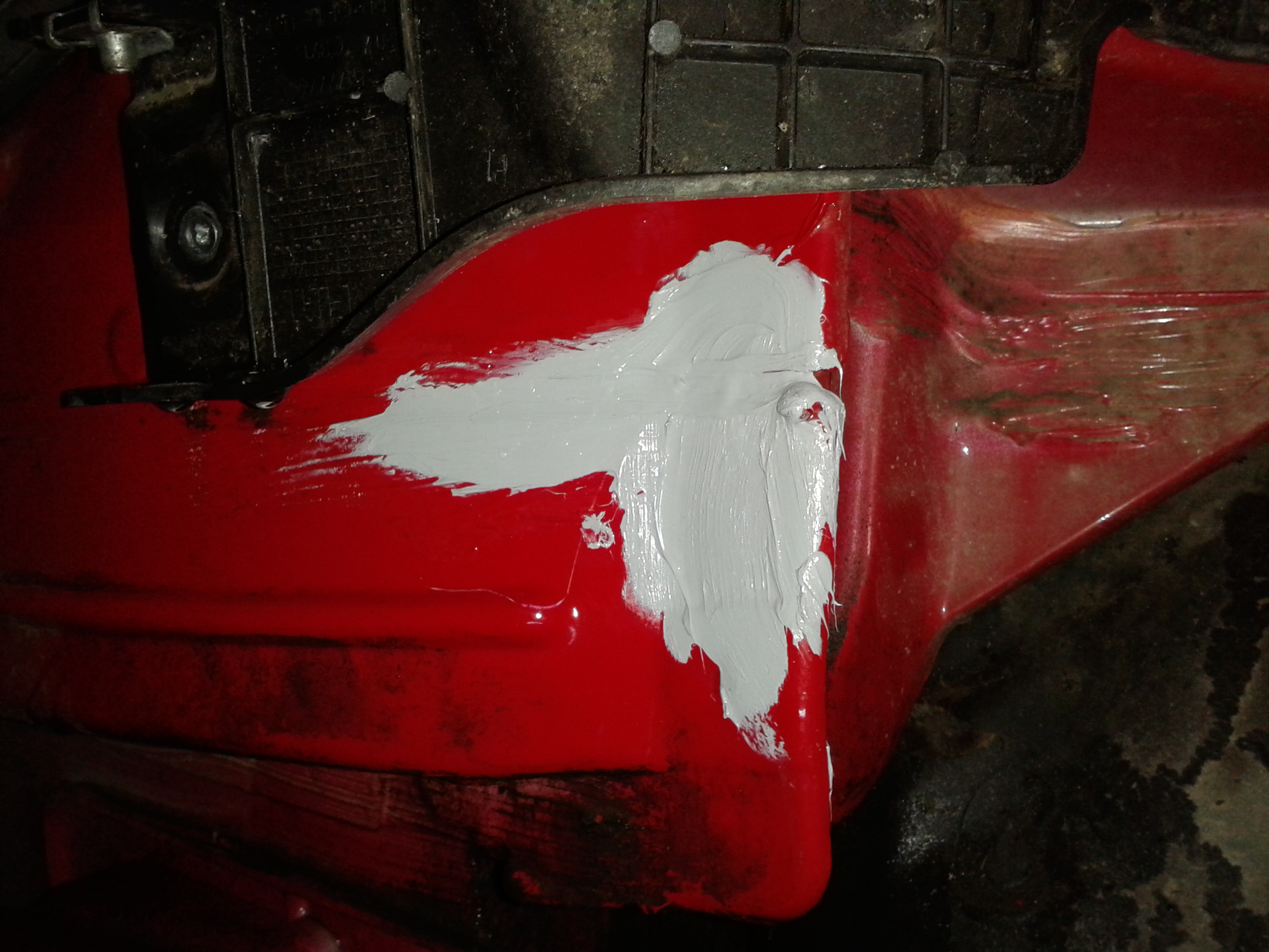

The problem is solved.
No, not because of my intervention fixing the brackets (previous post).
After the boot was filled with water again :bang:, I finally found the root cause.
When removing the bumper (again), I noticed a little hole (5mm) below the bumper bracket on the corner.
When I injected some water there, It flood out on the inside spot I already noticed...
I fixed the problem applying some sealant on the trouble spot.
After some hours in the rain, it's dry. I like to keep it that way :D...
Good work and good pictures. (y)
