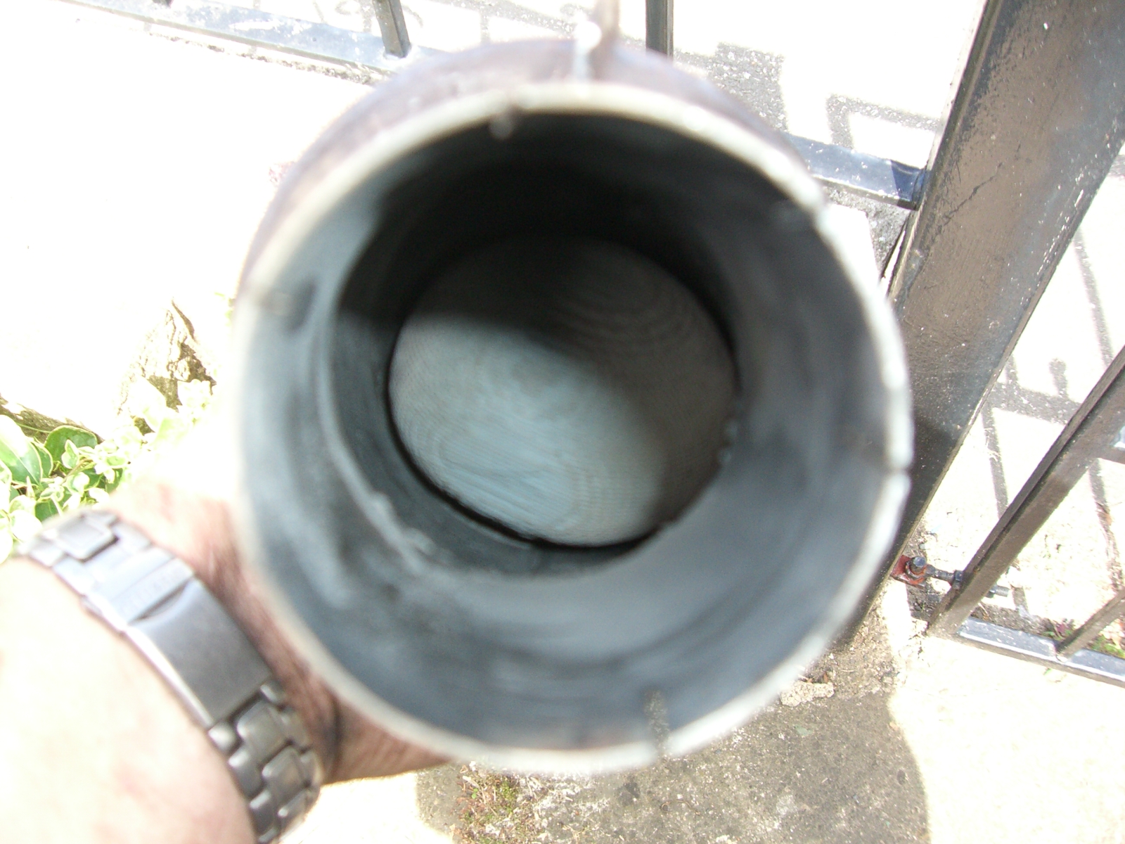

Right after the headgasket swap the other week the engine is running as smooth as anything:D
But before it went I had a little niggle with it seemingly been down on power one minute and perfectly ok the next. Now I still have this and it is annoying the hell out of me.
I think it is one of two things either the wastegate is sticking open for some reason or the cat has collapsed:mad:
It really does feal as though someone has stuck a potato up the exhaust pipe when it happens and there is also tinkling from the exhaust when you rev the engine which makes me think it's the cat. The only thing stopping me from ripping it out is that it is a very expensive stainless sports cat and it is lucky if it has done 2K miles
Any thoughts before I spend the afternoon swearing swapping the decat back in?
Assuming you have some kind of data logging with boost levels & TPS
If it's the turbo/wastegate I'd expect to see an increase in spool-up duration (in car the turbo responds quickly & actual lag is low but the spool-up becomes a smoother less punchy surge). While if it's the cat you're more likely to see an increase in lag but little change in the spool-up characteristics & the turbo tending to stall a bit faster when feathering the throttle.

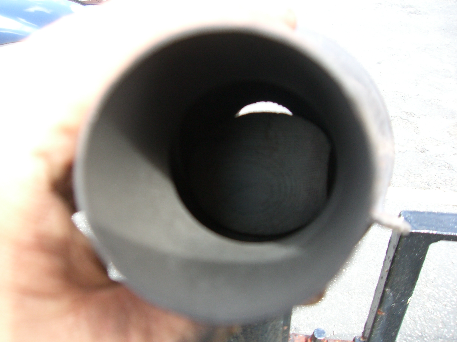

And the answer is.............................. Collapsed Cat:eek:
Basically the remains of the cat were in a ball the size of a cricket ball rolling up and down inside the cat can, so if you floored the throttle etc the remains were blocking the exhaust and depending which way the ball was facing you either got the open end of the honeycomb so had power, or it was side on so nothing.
