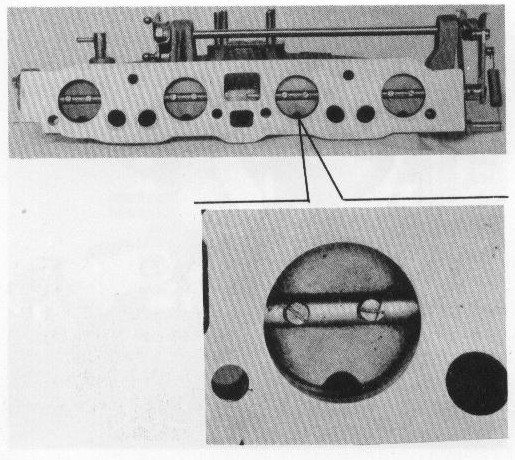

They do like resurrecting old technology and giving it a new name. 1985 Croma CHT (Controlled High Turbulence it was called then) had 4 extra throttle butterfly valves, one built into each inlet manifold duct.
