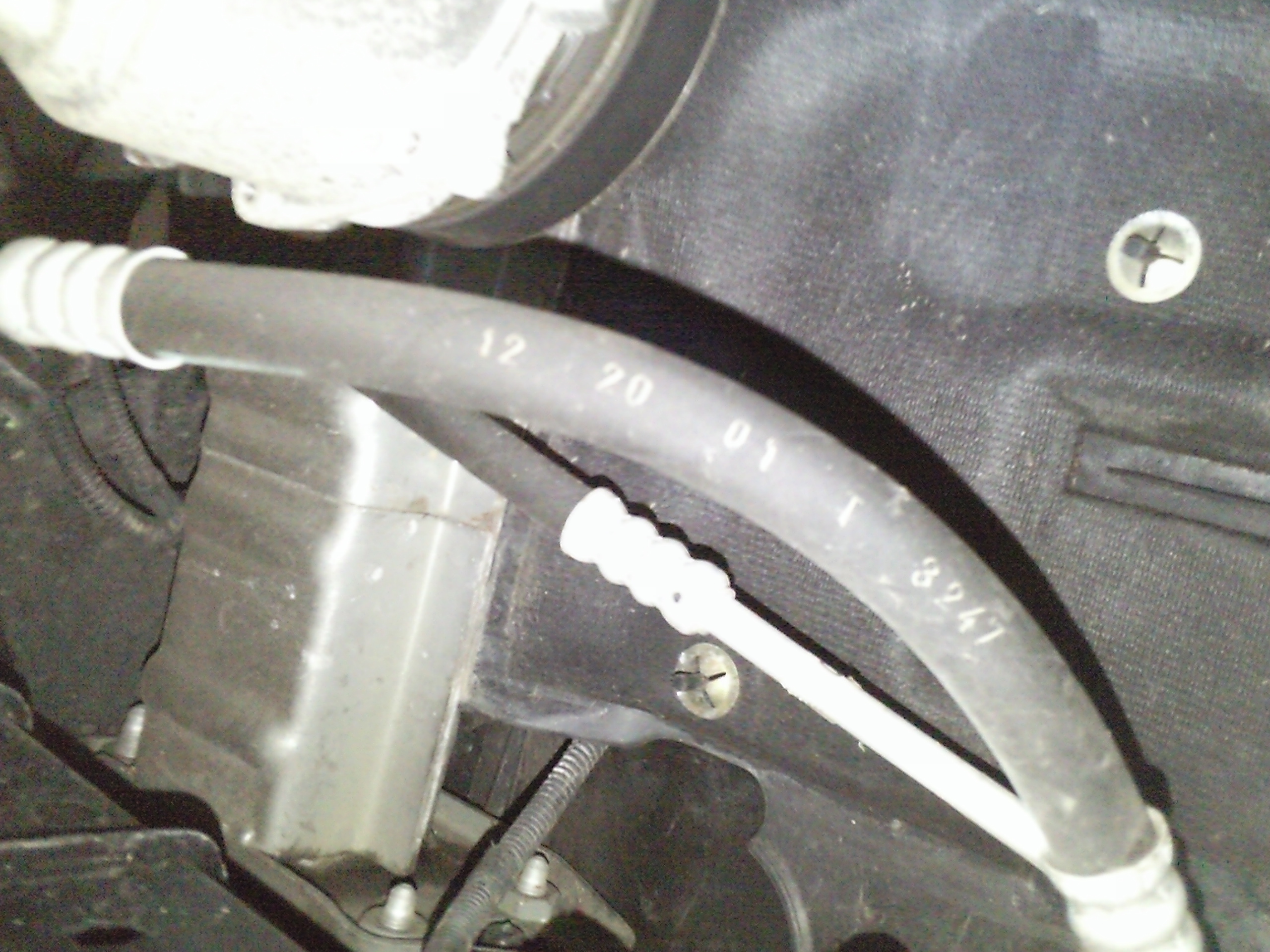

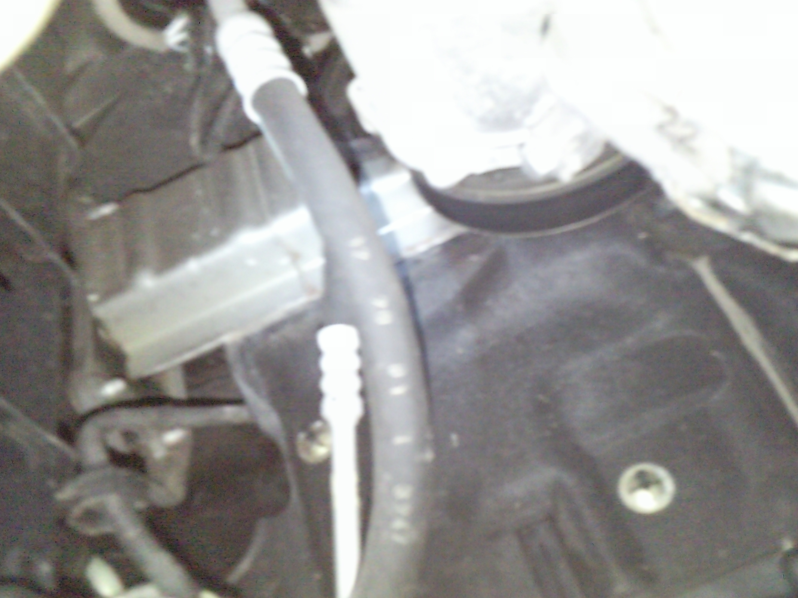

See the pics attached have i got the right pipe, air con has never worked, and want to know if there is an issue with the pipe, i didnt remove it, but i could not feel any kind of hole. Dont suppose you can tell from the pic if its the original or the new flexi version.

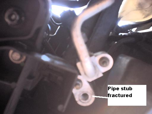

The one that seems to crack for everyone with earlier version Stilos is this one, in line and below the rh headlight
It's the rigid part of the pipe that cracks through not enough "give"
Newer pipes have much longer flexible part
You'd have a job feeling for a crack in the pipe, best idea is take it to an aircon specialist who will pump probably nitrogen in there and detect a large leak instantly
